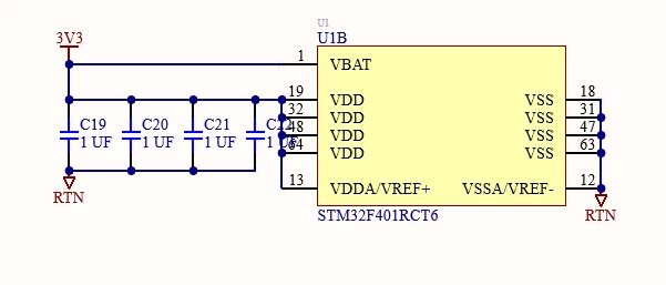

Make sure BOOT0 is pulled low, so isn't floating and high-ish as the MCU gains viability at around 1.2V
Check VCAP levels and caps. Adequate bulk capacitance, 2u2 individually or 4u7 collectively. Should be around 1.25V

Just adding to @Tesla DeLorean's list: make sure *all* VDD/VSS pins (including analog and VBAT) are connected as appropriate.

Boot0 is low, VCAP is stable, VDD and VSS are solid, our bypass values are 1uF per pin 0603, also we have a bulk 22 uF ceramic, we are using internal RC for clock and external 32 kHz crystal for RTC

Is VDDA connected directly to VDD?
How is VBAT connected?

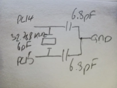

Ok, but what part# for your 32.768 KHz, is it a 6, 9 or 12pF class?
The F1, F2, F4 all really want 6-7pF oscillators,  and the caps you're using all strike me as being rather high
MC306-G-06Q-32.768 (manufacturer JFVNY), pair of 6.8pF
Regular C0G/NP0 caps should be fine. You want very short traces and board capacitance, so tight to the IC

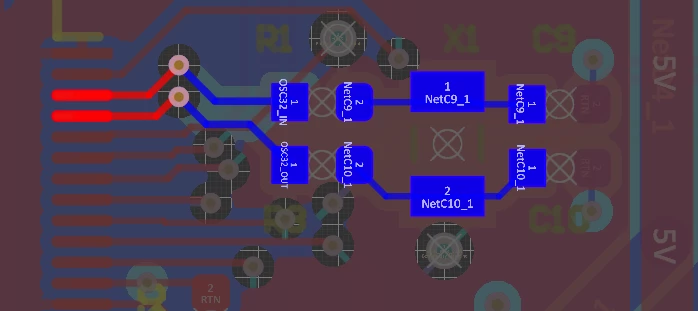

andrew sauter
Apr 8, 2024 2:28 AM UTC
These boards are built with this crystal  Raltron 32 kHz 12.5 pF
Layout: there is a continuous return on adjacent to the top and bottom side, but we change reference as it goes from top to bottom layer (no transitional via) there are two series elements both zero ohm, no ground cut, no guard trace, but also no significant adjacent noise sources.
My parasitic allowance was ~3 pF perhaps it is much higher. Which is surprising and the bare board does not measure higher using LCR meter DE-5000
Tesla DeLorean
Guru
Apr 8, 2024 2:48 AM UTC
Lot going on there, I wouldn't have gone with the via's like that, just straight to the crystal

I don't quite understand how the return is arranged, but it should not be tied to common ground but should be separate and as short as possible. Plus what @Tesla DeLorean said above. See AN2867.
OTOH, a really well designed crystal oscillator start up time *is* long (this is an implication not an equivalence, i.e. long startup does not mean the design is good). Thing is, that the oscillator starts up from picking up and amplifying noise, and well designed oscillator doesn't have too much noise to start from. 10 seconds is quite normal (and timeout should be even longer), so the application has to deal with this.
