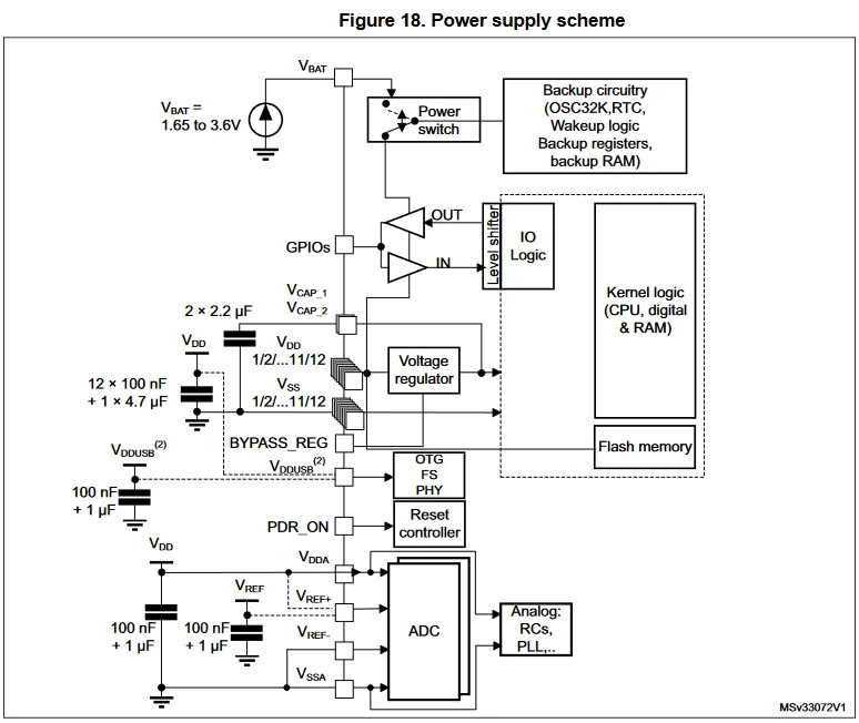

Hello. I use Timer 2 on STM32F401CCU6 to read rising and falling of clock signal. Timer 2 channel 1 in Input capture direct mode (Rising), channel 2 in Input capture indirect mode (falling). I registered an timer callback event and do some calculations. All work perfect. But when i try to do the same on the STM32F446RCT6 it's work with problems. For example, it does not read the state of the pin PA3. Sometimes the event is not executed at all. Maybe someone knows what the problem is?

I use this Power supply scheme:

Did you check the corresponding channel for timer 2 in datasheets?

Dear @Sem486 ,
I would recommend first to check hardware schematics and then power and clock settings
One is QFN48 pin  running up to 84MHz and F446 is LQFP64 running up to 180MHz . Power pins , VCAPs , VOS level I see that both in code above running from HSI with PLL at 84MHz and using VOS3 .
hope it helps you , Ciao
