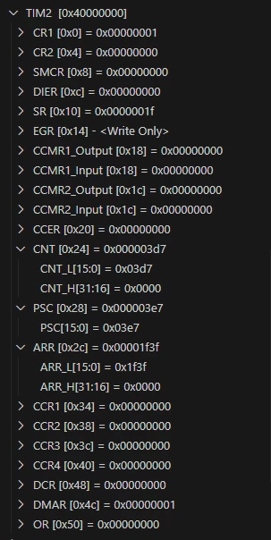

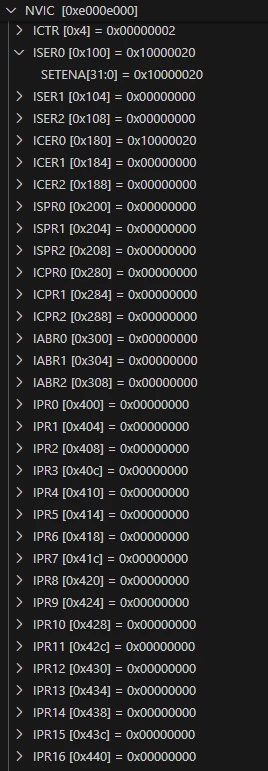

These are the values of the peripheral TIM2 and NVIC. Timer 2 is counting.

Read out and check/post content of TIM and relevant GPIO registers.

I forgot to call
TIM2-> DIER = TIM_DIER_UIE;
Is there a HAL Function to set TIM->DIER ?

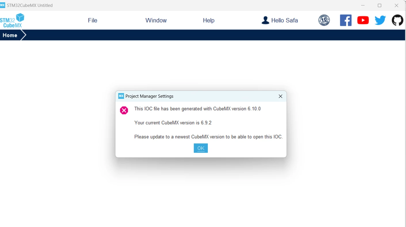

July 25, 2024
Hi when i try to open ur MX file it returns this i probably need to download the latest version but i dont want to the current one is working just fine . can u screenshot ur code for me i am working on the same thing but with a nucleo l152RE and ur work might help me figure it out
