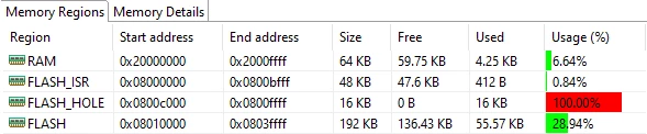

ChuckeroAuthor
September 8, 2023
Thank you all for the comments,
Considering that every erase cycle will clean the entire sector (which will happen at least once a day) and the risk highlighted when using sector 0, I liked the idea of reserve a vector for a sector, like:
#pragma location = 0x0800C000
uint8_t DATA_IN_FLASH[16383] = {0xFF}; /* DATA_IN_FLASH at fixed address: Sector 3 */
 This way I will have the entire sector 3 for data storage.
Thanks again!
ChuckeroAuthor
September 9, 2023
I've tried that code but looks like it does not work in GCC. I'm using STM32CubeIDE 1.12.0.
I've searched everywhere on the internet and I didn't find a solution that works, it's the first time I touch in the linker script.
So, what I did so far was different combinations of this:
In the c file:
uint8_t __attribute__((section (".myDataStorage"))) memoryReserve[16383];
In the linker script (first thing in SECTIONS):
/* Memories definition */
MEMORY
 RAM (xrw) : ORIGIN = 0x20000000, LENGTH = 64K
 FLASH (rx) : ORIGIN = 0x8000000, LENGTH = 256K
/* Sections */
SECTIONS
 /* Reserve section 3 from flash memory. */
 .myDataStorage 0x0800C000 :
 KEEP(*(.myDataStorage)) ;
 } > FLASH
 That way I got:
 - a warning in the STM32CubeProgrammer: Warning:The code is locked up!
 - flash memory, sectors 0, 1 and 2 (address 0x08000000 to 0x0800BFFF) are empty - 0xFF
 - flash memory, sector 3 (address 0x0800C000 to 0x0800FFFF) is empty - 0x00
 - the code starts at sector 4 (address 0x08010000)
 - the firmware does not run, because there is nothing in the boot sector (0x08000000)
I was imaging to have sectors 0, 1 and 2 for code, sector 3 for storage, and sectors 4, 5... for more code. I'm not sure if this is possible.
What is missing?
Tesla DeLorean
Tesla DeLoreanBest answer
Guru
September 9, 2023
Try this
/* Entry Point */
ENTRY(Reset_Handler)
/* Highest address of the user mode stack */
_estack = 0x20010000; /* end of RAM */
/* Generate a link error if heap and stack don't fit into RAM */
_Min_Heap_Size = 0x200;; /* required amount of heap */
_Min_Stack_Size = 0x400;; /* required amount of stack */
/* Specify the memory areas */
MEMORY
FLASH_ISR (rx) : ORIGIN = 0x08000000, LENGTH = 48K
FLASH_HOLE (rx) : ORIGIN = 0x0800C000, LENGTH = 16K
FLASH (rx) : ORIGIN = 0x08010000, LENGTH = 256K-64K
/* Define output sections */
SECTIONS
 /* The startup code goes first into FLASH */
 .isr_vector :
 . = ALIGN(4);
 KEEP(*(.isr_vector)) /* Startup code */
 . = ALIGN(4);
 } >FLASH_ISR
 .ARM.extab : { *(.ARM.extab* .gnu.linkonce.armextab.*) } >FLASH
 .ARM : {
 __exidx_start = .;
 *(.ARM.exidx*)
 __exidx_end = .;
 } >FLASH_ISR
 .preinit_array :
 PROVIDE_HIDDEN (__preinit_array_start = .);
 KEEP (*(.preinit_array*))
 PROVIDE_HIDDEN (__preinit_array_end = .);
 } >FLASH_ISR
 .init_array :
 PROVIDE_HIDDEN (__init_array_start = .);
 KEEP (*(SORT(.init_array.*)))
 KEEP (*(.init_array*))
 PROVIDE_HIDDEN (__init_array_end = .);
 } >FLASH_ISR
 .fini_array :
 PROVIDE_HIDDEN (__fini_array_start = .);
 KEEP (*(SORT(.fini_array.*)))
 KEEP (*(.fini_array*))
 PROVIDE_HIDDEN (__fini_array_end = .);
 } >FLASH_ISR
 .myDataStorage :
 . = ALIGN(4);
 . = ALIGN(4);
 } > FLASH_HOLE

One last question, about the memory optimization. Now I have this memory usage:
I notice the initial block (sectors 0 to 2) is using only 412 bytes.So, my first shot is to move my storage from sector 3 to sector 1. Other than that, can I freely play with the sectors in linker script? Is there something to avoid or "dangerous"? My intention is to fill as much of sector 0 as possible.
This is what I have in linker script following the suggestions:

Thanks again
Tesla DeLorean
Guru
September 12, 2023
The Linker Script  an be used to funnel the content of particular objects into the desired section. Perhaps cherry pick C library content to start filling that section
