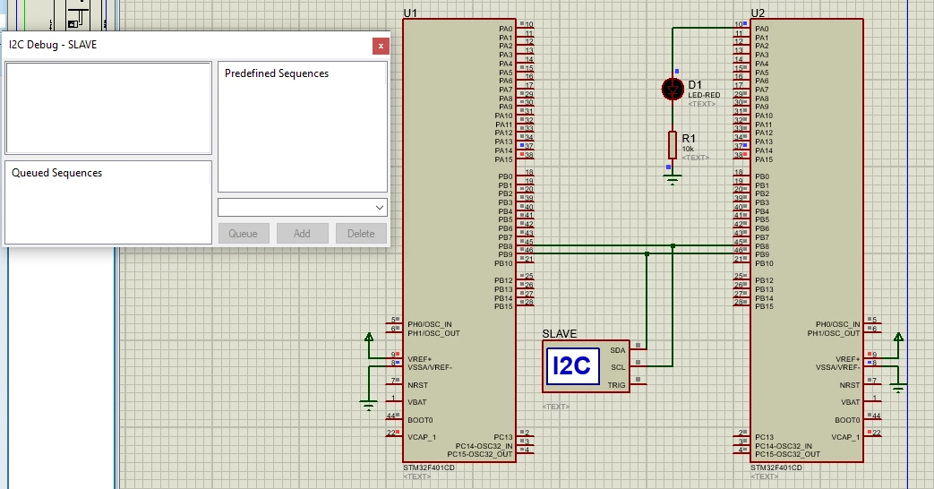

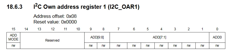

when i run the simulation there is nothing happened , the LED still off and PB8 , PB9 haven`t change , i want to know , if there any problem in my provided code, I followed the datasheet and manual of STM32F401xx to write this simple driver. is this the correct address will be passed to begin(addr) ?
and this is the simulation connection in proteus:

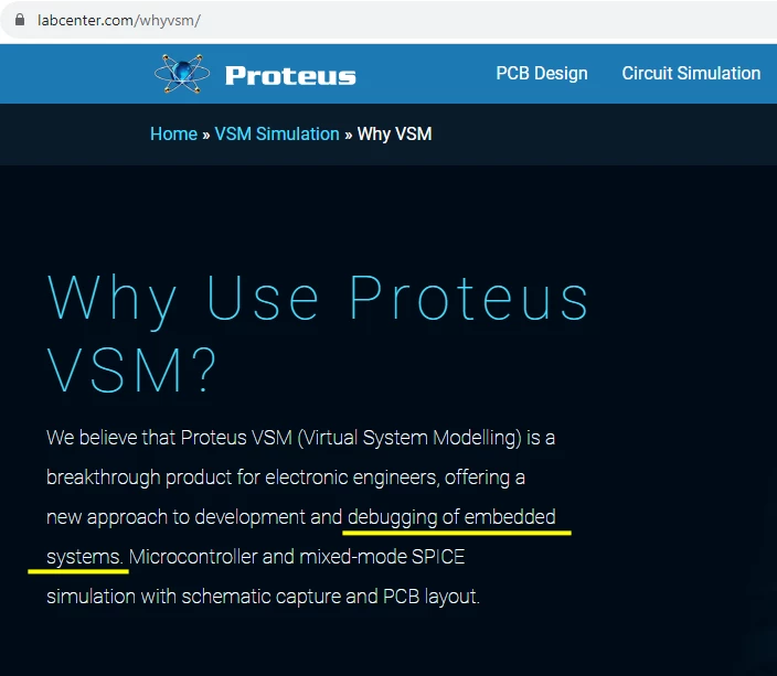

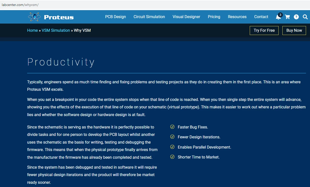

"i want to know , if there any problem in my provided code"
So what have you done to investigate & debug your code?
You're using Proteus - so you have both software & hardware debug facilities available to you...
https://www.labcenter.com/tutorials/
https://www.youtube.com/@LabcenterElectronicsLtd
