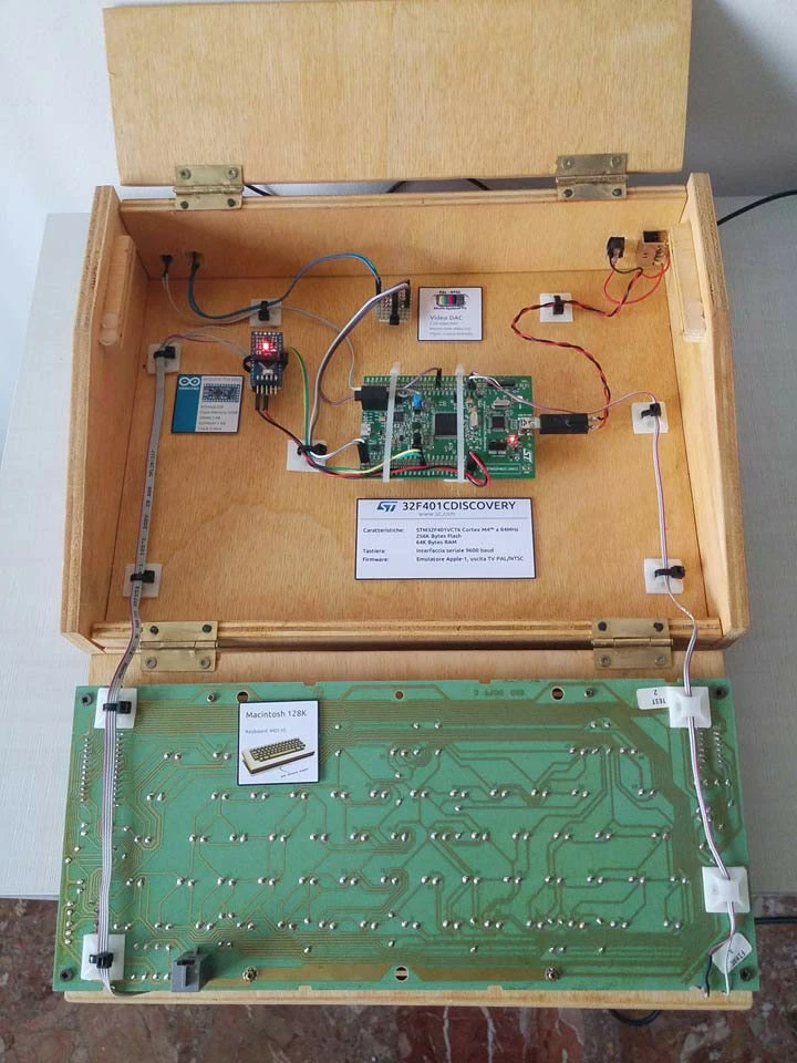

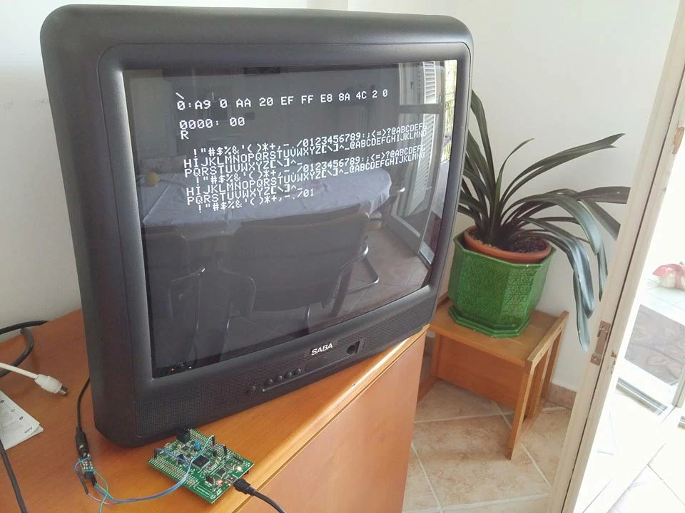

Hello to All,
recently I coded an emulator of an old Apple-1 inside a STM32F401 Discovery board. It is capable to generate a PAL/NTSC composite video signal, it's interfaced to an old Macintosh 128K keyboard through an Arduino Mini Pro. Currently all programs made for the Apple-1 can run on it, but now I am trying to develop a driver/interface to save or load program to/from a tape player. This is a tricky part because it should run almost in real time to save the signal correctly.
I am evaluating different options, but it's not easy because the clock of the emulated 6502 has to be 1Mhz, and I can't use an interrupt to execute one instruction a time without interfere with the TV signal generation.
The 401 is clocked at 84MHz, I was wondering if using something faster like a 429 the 1MHz interrupt can be handled better.
Thanks.

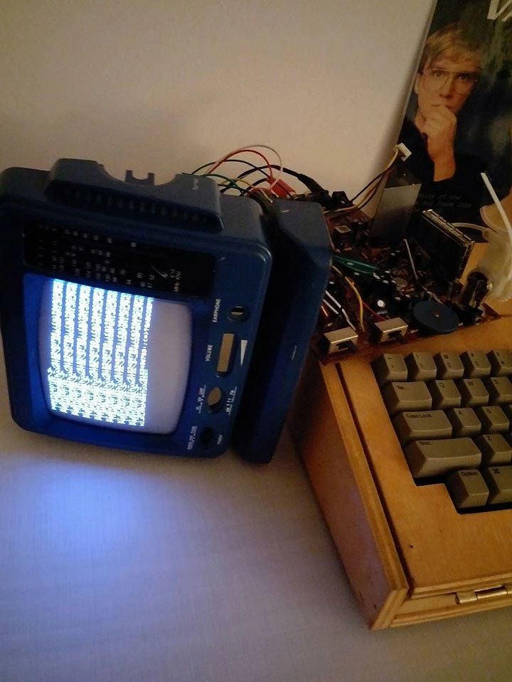

    I can't simply execute a number of instructions each video frame, synchronized by the video driver, because the emulated CPU results in a irregular speed when outputting the signal.
    I tried different ways... but not good results. Tried to execute a number of instructions each scanline, but that resulted on a huge jitter in rendering the graphics. Tried also to use the Systick timer configured at 1MHz to execute instructions, and it partially works. The result is a better signal but not enough good for my purpose.
