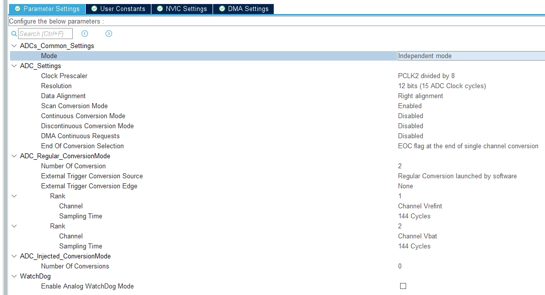

During simple task I need to measure Vrefint and Vbat, so, I open CubeMX and configure ADC to read Vrefint and Vbat
Than I setup a DMA to read values...

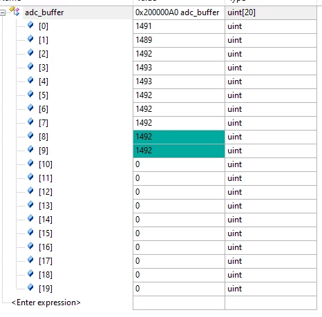

But I faced with really strange issue

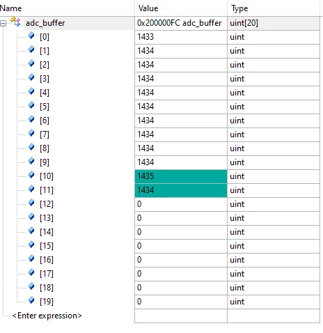

When I configure Rank1 and Rank2 as Vrefint and run my program I get such results (i.e. ref value is 1492)
(value stored at 0x1FFF 7A2A close to this value, so, reading is correct)

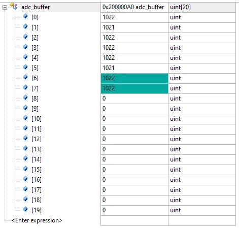

When I configure Rank1 and Rank2 as Vbat and run my program I get such results (i.e. Vbat value is 1021)

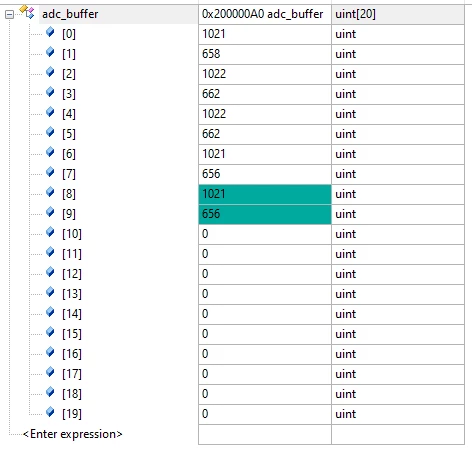

But when I configure Rank1 as Vbat and Rank2 as Vrefint I get such values (also I can configure Rank1 as Vrefint and Rank2 as Vbat):
i.e. Vbat is 1021 (as previously) and Vrefint is 656 (previously 1492)

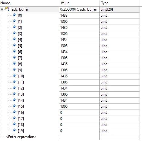

I try just the same project / firmware for NUCLEO-L476RG demo board

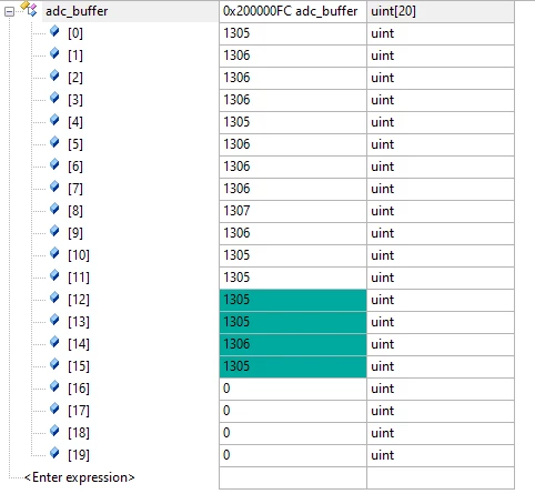

only Vbat measuring (1306)
only Vref measuring (1434)
Vrefint (1434) and Vbat (1305) measured together in a raw
So, the same project/software works correctly for F476 and doesn't work for F401

waclawek.jan
January 20, 2025
This is consequence of a bizarre limitation in some (most?) 'F4, that you need a software intervention - switching on/off ADC_CCR.TSVREFE and ADC_CCR.VBATE - between measuring VBAT and VREFINT (and internal temperature sensor).

Previously I try manual switching, but it doesn't help
But now I know where to look at :)
