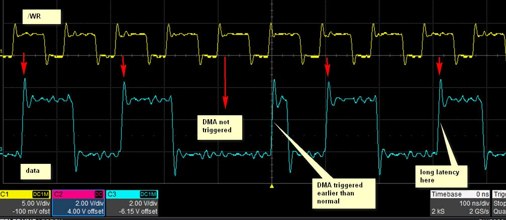

I am using TIM8 to generate a PWM waveform (a /wr signal to an LCD ST7789 controller) and the timer triggers DMA2 to load the next byte onto the PD8-PD15 bus. The 1st byte has to be loaded “manually”.
It works, and the ARR CCR3 CCR4 values can be adjusted to get the desired overall period, and data setup and hold times.
At 84MHz APB2, I am using ARR=11 to get a 71ns cycle time. So this thing is running pretty fast. The timer resolution is 1/168MHz. The ST7789 can go down to 66ns.
The problem is that roughly once in a million writes, bad data is loaded. It shows up as wrong colour pixels. With extensive debugging, AFAICT, the bad data is not present in the source buffer. What I do see on a scope is very rare faint edges on the data, around the /wr +ve edge, on which the data setup/hold time is out of spec. Sometimes the data changes at the same time as the /wr +ve edge!
Using ARR=15 or higher, the problem goes away. But then I get too-slow transfers.
It looks like there is a very rare huge latency in the DMA transfer, so the data on the PD8-PD15 bus is still the previous value. The correct number of writes takes place however, as only the one pixel (2 bytes, 16 bit RGB) is corrupted. In fact you need a magnifying glass to see the “snow”, on a 240x320 LCD.
To some extent the minimum ARR value needed to remove the “snow” depends on what else is running. DMA1 is also in use, for feeding SPI3, under another RTOS task. Then ETH has its own DMA controller. So there is opportunity for bus contention.
The really funny thing is that the “snow” pixels pop up 3-5x, at roughly 3Hz (on a 20fps display redraw) and then vanish for a few secs, then repeat. In the same place. So whatever is causing this is somehow synchronous to what DMA2 is doing. DMA2 is not used for anything else but DMA1 is.
What is the worst-case latency, and is there anything I can do to improve it? There is a priority setting but it applies only within DMA2 channels. It looks like very rarely the latency might be tens of ns.

A lot of time was spent on ARR CCR CCR4 values. There is a DMA trigger delay from
CCR4 to the DMA actually doing it, causing it to sometimes read what is probably the
same byte again, causing specs on the display. The probability is of the order of
1 in 100k. One needs to test with USB VCP and ETH all running. There is still
a little bit of snow with these settings but not readily visible.

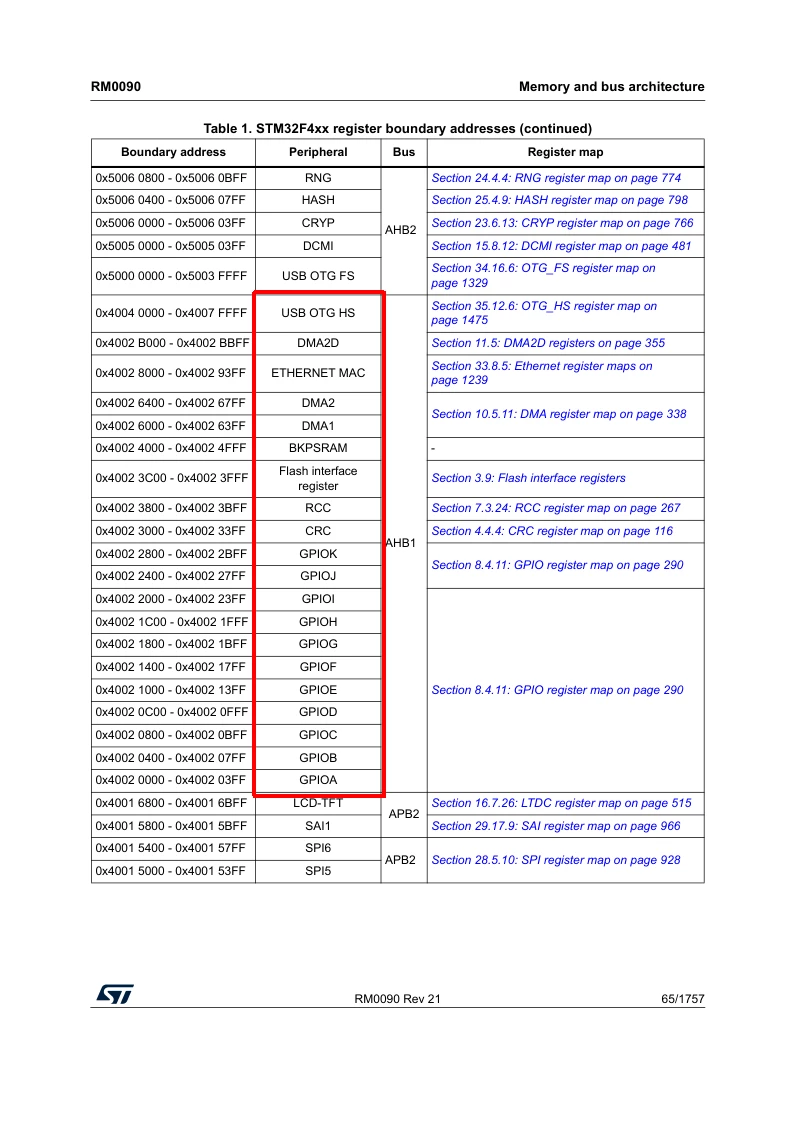

waclawek.jan
June 22, 2026
  1. AN4031 discusses the latency within the dual-port DMA, although the details are not crystal clear. Assuming memory-side loads are fast enough (see 3), and assuming no other DMA Stream is active within that DMA, I’d say, 3-5 cycles from TIM8_CH4’s “active” (CC) edge to the moment where DMA starts to output data onto the bus matrix.
  2. There’s probably one cycle of arbitration at the bus matrix, if the given target bus (where GPIO sits, i.e. AHB1) is free. But it may not be. Look what else is at AHB1:
note, that these are the “register interfaces” not “data interfaces”, in case of ETH, DMA2D and OTG HS. If processor, or any other master (e.g. DMA1, but that’s unlikely) accesses any of those modules’ registers, that may create a conflict and DMA2 may need to wait. Note, that DMA’s own registers are there, too, i.e. polling DMA’s status register by processor may create such delay, too. Also, some ETH registers are in a different clock domain than AHB, so reading those may (or may not, depending on the particular implementation, and I am not sure how well is this documented) impose somewhat more than just one or two cycles of delay.
  1. You appear to use Direct mode of DMA (i.e. no FIFO), byte wide. That means, that after DMA outputs a byte to its Peripheral port, i.e. the towards GPIO, it starts to read in the next byte from Memory port, presumably from SRAM. If there is a serious bus contention there, it may have an impact. (For example, ETH may be set up to read/write data in bursts, both “real” data and the scatter-gather-descriptors, and that means it occupies the given memory/bus for several cycles. DMA2D also uses 8-beat bus cycles, as we’ve learned just today.) This is not part of timer-to-DMA-to-GPIO latency per se, but adds up to the “total turnaround time” for given byte.
The simplest thing to do is to enable DMA FIFO and observe if the problem goes away. After enabling DMA I’d wait a tad bit (perhaps setting up TIM8 registers meantime) before enabling TIM8, to allow the FIFO to fill up.
If this won’t help, 2. is probably the problem, so then at least as an experiment I’d avoid accessing any registers from AHB1 for the duration of DMA transfer (which then also shouldn’t be polled but handled in its TC interrupt).

I am using my 3034 scope with a qualified trigger, +ve /wr clock edge followed within <10ns by a data edge (a fail on data hold time; should never happen) and I am seeing lots of weird stuff according to the ARR CCR3 CCR4 values. ARR is the timer cycle time, CCR3 is the +ve /wr edge, and CCR4 is the DMA trigger. Any ARR below 15 (168MHz periods, this is) produces snow. I can’t trigger the scope on “snow” but this qualified trigger shows
one event where DMA was not triggered but then got triggered with a very short latency, and the rightmost case shows a DMA trigger latency some 20-30ns later than normally happens.
The ARR CCR3 CCR4 values for the above are 15 6 5. In theory CCR4 should be >= CCR3 but CCR3 produces the /WR +ve edge instantly whereas the DMA transfer takes much longer, so I am playing with different (shorter) values for CCR4.
Unless I am missing something, there are real problems with timers triggering DMA. You can basically forget anything below say 50ns. But the DMA latency can be ~zero especially if it missed the preceeding trigger.
But it works (11 5 5 produces no scope triggers) and for driving an LCD whose display is totally redrawn at 20fps+ the snow, visible only with a magnifier, can be tolerated.
Actually I am not even sure the snow is caused by these DMA latency artefacts because I see snow even where the scope is never triggered (by a hold time violation).
The fact that with ARR=15+ I see no snow proves this issue is not caused by some other task corrupting the data bus. I spent a lot of time on that :)

But in the meantime I have noted one thing: There are no scope artefacts (eg hold time violations) or LCD corruption on short dma transfers. It needs something like 50 bytes minimum before it breaks. It is as if some error accumulated during the transfer. Incredible.
waclawek.jan
June 23, 2026
The “DMA not triggered” followed by “DMA triggered earlier” is not true. In fact, the “DMA triggered earlier” is the DMA which is supposed to be trigged by the “DMA not triggered” edge, with a latency of almost whole ARR cycle. If ARR is 11, that latency here may be 8-9 cycles, which is very much in line with the theory that something occupies some of the buses for some 8 cycles, and that may very well be a 8-beat DMA burst from some other master (ETH, DMA2D, OTG-HS), into the same RAM.
So, maybe putting the LCD buffer to a different RAM could help.
And without FIFO?
With DMA FIFO on, you can also change the memory-side transfer width to word. The addresses and sizes have to be aligned (i.e. multiples of 4), too, but I believe that’s not an issue with the usual LCDs.
Also, you did mention you do use ETH. Have you tried to disable it, to see impact on display?
If it helps, check content of ETH_DMABMR, you may want to play with PBL/RDP/FB/USP/PFM bits/bitfields.

With no ETH in the build, the snow is the same, regardless of USB activity.
So I doubt if the snow is the same problem as the above DMA latency illustration, because the snow appears to be very frequent - probably of the order of tens of funny pixels popping up somewhere, each second. But the above DMA latency is much more rare - of the order of once every few mins.
With no ETH in the build I cannot see any cases of the DMA latency, no matter what I do on USB. But as I say above, same snow.
With ETH in the build and a fair bit of ETH traffic I can see the latency problem but it can be once in some minutes. This is with the FIFO; the FIFO did not seem to change anything.
Having a lot of USB VCP traffic (I cannot easily build without USB in my current setup) does not seem to have any effect. This is USB FS, not HS, BTW.
So I think they are two different things, and I cannot see how I could trigger the scope on the “snow”.
I was wrong about the snow never appearing within the first say 50 bytes of a DMA transfer. It does, but much more rarely.
I can’t really feed the DMA from another bit of RAM because in my project the RAM is basically the “classic” layout i.e. BSS, stact, the heap between the two. The CCM (which on the 32f4 is not DMA-accessible anyway) is reserved for RTOS stacks; that decision could be argued both ways but I find the 64k CCM is well sized for all my FreeRTOS stacks, with some 20-50% free depending on the build.
It is possibly true that enabling the DMA FIFO did enable the snow to appear more randomly over the display. Previously it wasn’t doing that.
If the snow is unchanged with ETH entirely removed from the build, then superficially it appears that ETH-related bus contention is not the cause of the snow, and playing with ETH_DMABMR (PBL/RDP/FB/USP/PFM — those tune the ETH DMA's burst length and behaviour) will do nothing for the snow. BUT I can trigger the scope on the ETH-related probable long DMA latency, so I will work on that. The two may be related in some subtle way, or something else (other than ETH) may be grabbing the bus.
Changing
dmainit.TxDMABurstLength = ETH_TXDMABURSTLENGTH_32BEAT;
to
dmainit.TxDMABurstLength = ETH_TXDMABURSTLENGTH_1BEAT;
(for both TX and RX)
does not (as expected) change the snow but does almost remove the DMA latency event. It was the ETH_RX… that made the difference, not the ETH_TX… one.
Stepping back up (doing both TX and RX):
ETH_TXDMABURSTLENGTH_16BEAT - latency events
ETH_TXDMABURSTLENGTH_8BEAT - latency events
ETH_TXDMABURSTLENGTH_4BEAT - latency events
ETH_TXDMABURSTLENGTH_2BEAT - rare latency events
ETH_TXDMABURSTLENGTH_1BEAT - almost no latency events; this value chosen for now
I have no particular ETH performance requirements; the TX is effectively polled (LWIP sends a packet to ETH when it has one from the socket application) and the RX is polled in an RTOS task to ensure that a rogue device on the LAN cannot hang the product, limiting the speed to a few hundred kbytes/sec which is more than enough.
But the burst length is not a complete solution.
If you have any ideas on the snow, I am all ears :)

To add: a quick and dirty test with 32 bit loading seemed to produce a lot less snow. So I will try to implement that if datasize is a multiple of 4.
The problem is that the 1st byte has to be manually set up, which makes this rather messy… The DMA will be fetching 4 bytes at a time, so the part of the buffer after the 1st byte needs to be 4-aligned.
This is worth doing because a) the vast majority of data on this project is a multiple of 4 and b) loading up 4 bytes at a time must improve any contention with other bus masters.
PHolt.1
PHolt.1Author
Senior
June 25, 2026
After many more hours, I can report that enabling the DMA FIFO does nothing.
Switching the load width to 32 bits might solve some or all of it. I got some clean drawing but “wrong graphics” because there is a complication: if you use the “timer pwm mode” to generate the /wr pulse and then to trigger the dma to load the next byte, you have to load the 1st byte “manually” and then dma can load subsequent 4 byte blocks, which means the source buffer (wherever it is) has to be 4-aligned after the 1st byte :) It gets just too messy.
So I went back to the 15 cycle config; 89ns cycle ie 11.2MB/sec and that is the fastest possible which produces no snow, no massively time-shifted data loads (due to dma latency) but is well below the ~15MB/sec possible with the ST7789 (and easily achieved by bit-banging PD8-PD15 albeit with 100% CPU loading).
The ETH DMA burst lengths (post above) do not really have much or any effect with the 15 cycle config, so something else is going on here.
I wonder if there is a way to avoiding the manual load of the 1st byte. Basically a way to enable the DMA to move the data and then trigger the timer to produce the /wr, and repeat. Maybe with chained dma channels?

The initial byte load is now done with DMA too, and that works as suggested above - thank you. It doesn't seem to improve anything (as expected) but it much simplifies the 32 bit DMA load mode.
Unfortunately, tests of the 32 bit DMA load mode found that while it works fine it showed no measurable improvement in anything (either the snow or the large latency events) and while the 32F4 does support unaligned 32 bit ops, it does not support them for DMA, so this narrowed down the usability of this function. I did lots of timing tests and interestingly it turns out that using DMA, rather than bit-banging the 8 bit port and the /wr, is faster for even 1 pixel (probably because, in reality, 1 pixel is an 11-byte write to set the address and then 2 bytes (5,6,5 RGB) to set the pixel).
Clearly, ETH DMA has an effect. A build without ETH shows zero excessive latency events, over hours. As I wrote above, I tried reducing the ETH DMA max burst lengths and going down from the max (32) to 1 has the same effect as building without ETH. In this project I am doing, there is no performance requirement for ETH. It is extremely time-consuming to test this but it looks like a max burst of 2 is almost as good, and 1 removes the ETH related latency entirely. Is there any penalty in doing this? At 100mbps ETH, 12MB/sec, if there is a TX under-run, it should result in a bad CRC so the other end will NACK it. But not with UDP. But pretty obviously the ETH DMA has a very high priority. I have TLS etc running and observe no problems.
Is there a DMA priority setting for DMA2 versus DMA1? AFAIK there is a priority setting only within DMA2 streams for example.
I do use DMA1 for SPI3. DMA2 is used only for this LCD controller.
This kind of latency does pretty much bugger up the whole scheme of using a timer for PWM to generate the /WR and then triggering DMA to load the next byte! Unless you run much slower e.g. 1MHz. Tens of MHz is readily achievable with APB2=84MHz (168MHz CPU, TIM8 runs at 168MHz) but you can't do uch with it unless you find some way to eliminate DMA latency. In the LCD driving context, one has to make sure that the whole display is refreshed periodically. Then some artefacts can be tolerated, especially if they are near-invisible to start with. The snow cannot be tolerated though. But the whole issue simply does not happen on short DMA transfers e.g. tens of bytes, so you can draw a clock and let it run for weeks.
Why 32 bit DMA loading did not help with the DMA latency, is a mystery.

I am updating this to say that after many days of tests the latency appears to be entirely due to the ETH DMA controller.
Even with ETH_RXDMABURSTLENGTH_1BEAT there are errors.
Maybe even with ETH_RXDMABURSTLENGTH_1BEAT the DMA is still grabbing the bus for extended periods.
waclawek.jan
July 2, 2026
I wouldn’t trust Cube/HAL and check the actual content of  ETH_DMABMR, or just simply write directly. I would check also the other bits there, not just the burst lengths.
Note, that it’s not just the data on the wire which go through this interface, but the descriptors, too.
I probably already mentioned also that one of the ways how to isolate ETH from other masters (like DMA) is to use a different piece of SRAM (i.e. SRAM1 for DMA, SRAM2 for ETH).
