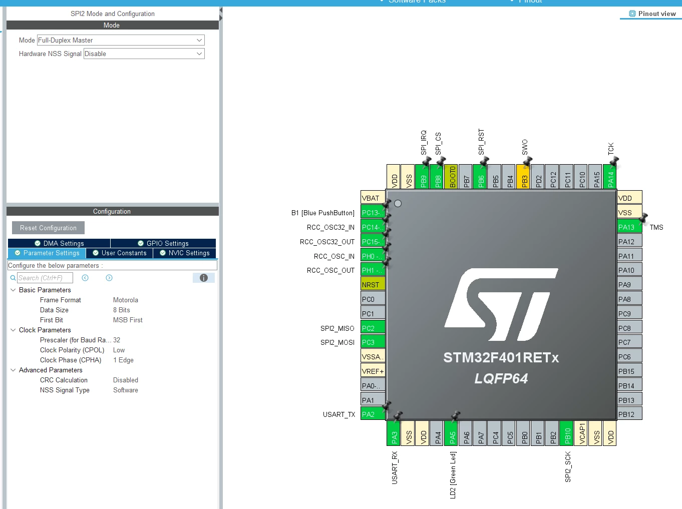

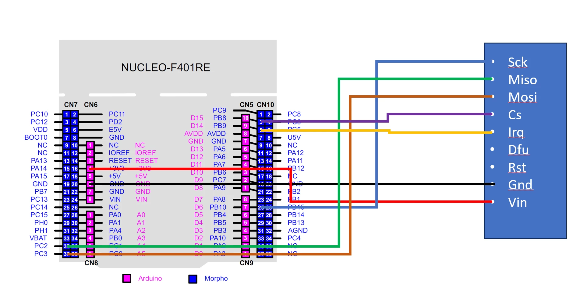

Hello st community,
I'm trying to set up a bleutooth communication between my phone and my stm32 with the Adafruit module in SPI communication, but I'm having a problem.
When I use my arduino and the demo code it works perfectly but when I connect to my stm32 and do my code based on the demo code I have a problem during the factory reset, the module shuts down and I can't see the ble module on my phone.
I have checked my wires 3 times and also the power supply provided by the nucleo I have the 3.3V

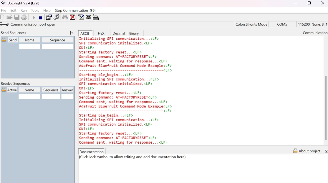

I use doclight to monitor uart communication for debugging

 UART_Print(&huart2, "Adafruit Bluefruit Command Mode Example\n");
 UART_Print(&huart2, "---------------------------------------\n");
 UART_Print(&huart2, "Starting ble_begin...\n");
 if (!ble_begin())
 UART_Print(&huart2, "Couldn't find Bluefruit, make sure it's in Command mode & check wiring?\n");
 while (1);
 UART_Print(&huart2, "OK!\n");
 if (FACTORYRESET_ENABLE)
 UART_Print(&huart2, "Starting factory reset...\n");
 if (!ble_factoryReset())
 UART_Print(&huart2, "Couldn't factory reset\n");
 while (1);
 UART_Print(&huart2, "Factory reset complete\n");

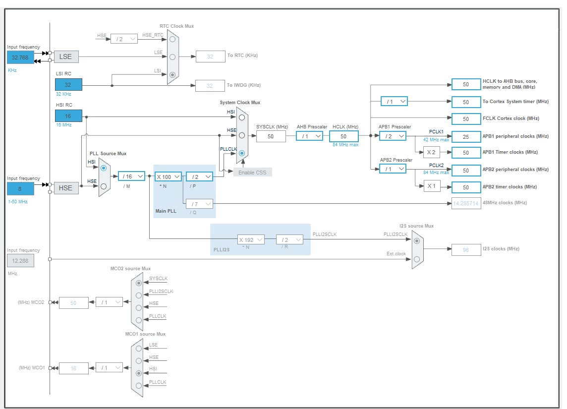

 void SystemClock_Config(void)
 __HAL_RCC_PWR_CLK_ENABLE();
 __HAL_PWR_VOLTAGESCALING_CONFIG(PWR_REGULATOR_VOLTAGE_SCALE2);
 RCC_OscInitStruct.OscillatorType = RCC_OSCILLATORTYPE_HSI;
 RCC_OscInitStruct.PLL.PLLSource = RCC_PLLSOURCE_HSI;
 RCC_OscInitStruct.PLL.PLLM = 16;
 RCC_OscInitStruct.PLL.PLLN = 100;
 RCC_OscInitStruct.PLL.PLLP = RCC_PLLP_DIV2;
 RCC_OscInitStruct.PLL.PLLQ = 7;
 Error_Handler();
 RCC_ClkInitStruct.APB1CLKDivider = RCC_HCLK_DIV2;
 RCC_ClkInitStruct.APB2CLKDivider = RCC_HCLK_DIV1;
 if (HAL_RCC_ClockConfig(&RCC_ClkInitStruct, FLASH_LATENCY_1) != HAL_OK)
 Error_Handler();

 static void MX_SPI2_Init(void)
 /* USER CODE BEGIN SPI2_Init 0 */
 /* USER CODE END SPI2_Init 0 */
 /* USER CODE BEGIN SPI2_Init 1 */
 /* USER CODE END SPI2_Init 1 */
 /* SPI2 parameter configuration*/
 hspi2.Instance = SPI2;
 hspi2.Init.Mode = SPI_MODE_MASTER;
 hspi2.Init.Direction = SPI_DIRECTION_2LINES;
 hspi2.Init.DataSize = SPI_DATASIZE_8BIT;
 hspi2.Init.CLKPolarity = SPI_POLARITY_LOW;
 hspi2.Init.CLKPhase = SPI_PHASE_1EDGE;
 hspi2.Init.NSS = SPI_NSS_SOFT;
 hspi2.Init.BaudRatePrescaler = SPI_BAUDRATEPRESCALER_2;
 hspi2.Init.FirstBit = SPI_FIRSTBIT_MSB;
 hspi2.Init.TIMode = SPI_TIMODE_DISABLE;
 hspi2.Init.CRCCalculation = SPI_CRCCALCULATION_DISABLE;
 hspi2.Init.CRCPolynomial = 10;
 if (HAL_SPI_Init(&hspi2) != HAL_OK)
 Error_Handler();

I want to send a data frame from my phone (like pressing a button) and receive data back to my phone (like ‘button 6 is pressed’) with the Bluetooth module.

Show your schematic of how you have the module connected to the STM32
Have you used an oscilloscope or logic analyser to see what's happening on the wires.

I'm using the STM32F401RE. Below are some images of the configuration and connection.
Unfortunately, I don't have an oscilloscope or a logic analyser.
I want to use SPI to learn how to communicate with SPI and also because it's faster than UART communication.
Best regard.
