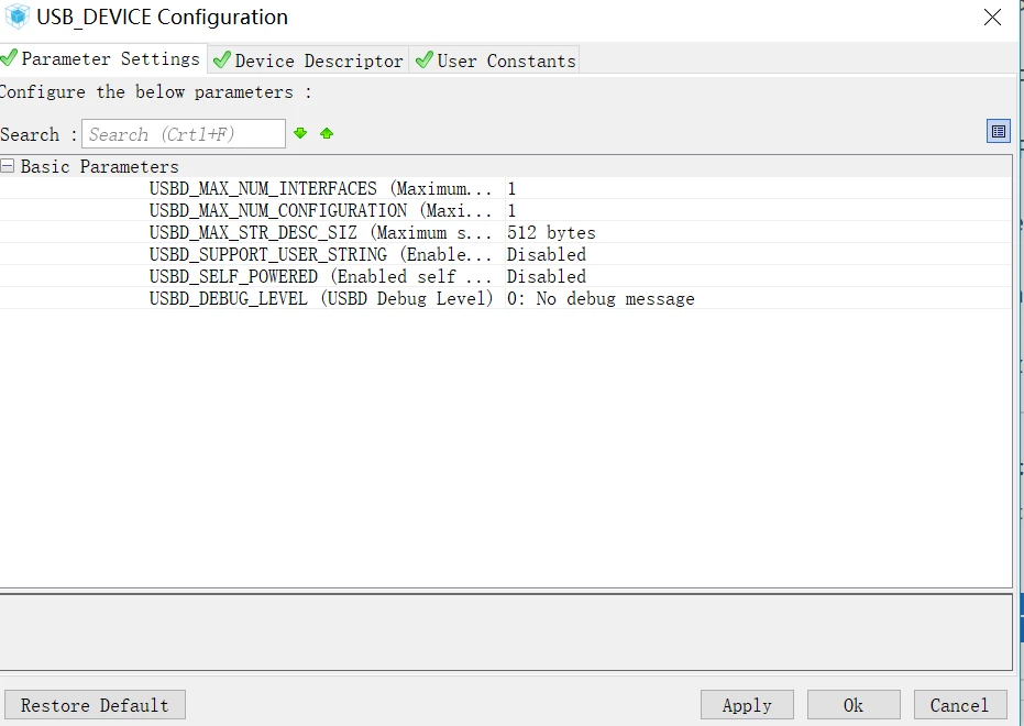

I am testing out the USB HID (otg fs) feature of my board with stm32f407vet6 mcu. I used stm32cubemx to configure it and i didn't add anything to the while loop in main c, just seeing if the device can be detected or not. However, after I uploaded  the code  and resetted the board, no response was given and I could not find any relevant port in the device manager of my pc.  The attached are the schematic for the usb_slave port and configuration in stm32cubemx.

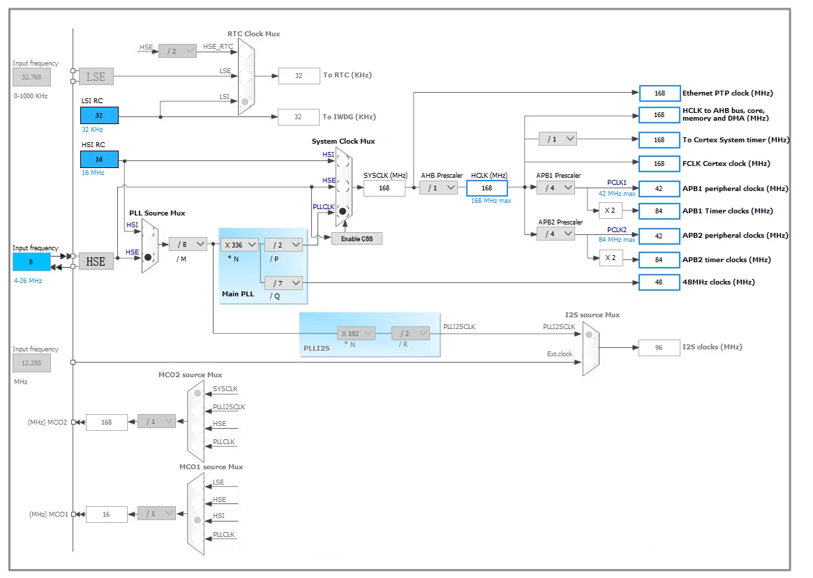

    Hello
    sirsargras
    Can you show us your clock configuration? Clock is in most cases main problem why USB does not work.
    Best regards,
    Tilen
    YONGAN ZHANG
    August 8, 2017
    Posted on August 08, 2017 at 14:06
    Hi
    Majerle.Tilen
    This is my clocking configuration; the clocking for usb is 48Mhz I think.0690X00000607wgQAA.png

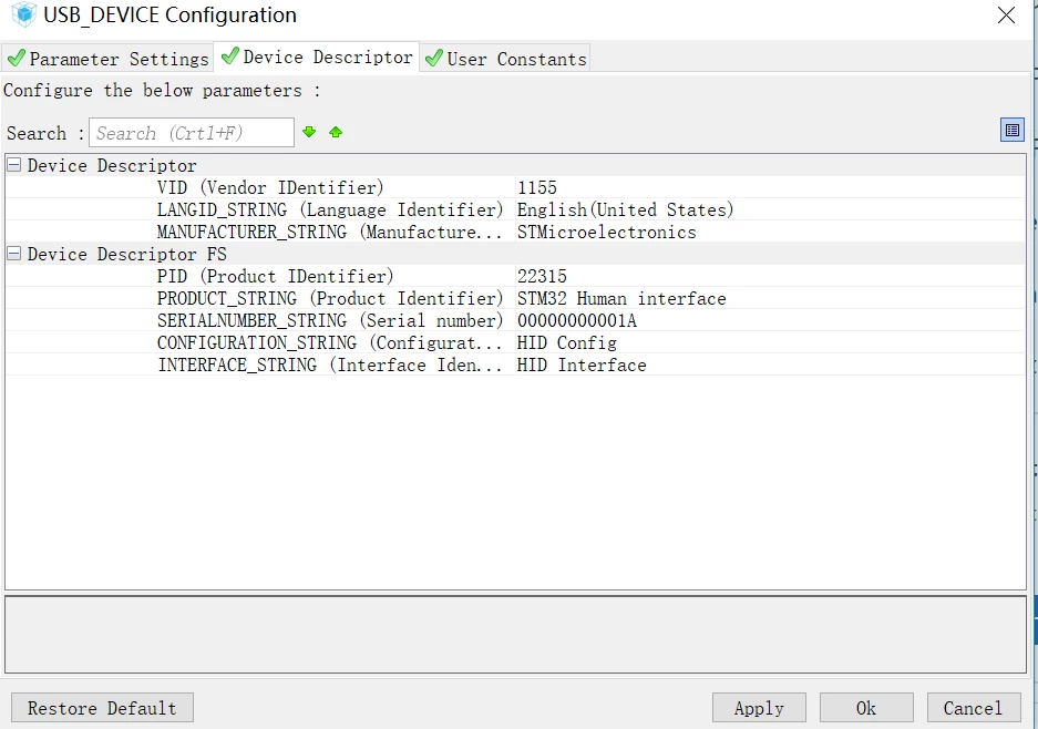

    please share with us .ioc file from CubeMX.
    Best regards,
    Tilen
    YONGAN ZHANG
    August 8, 2017
    Posted on August 08, 2017 at 14:17
    The .ioc file is updated in the original post. Thank you!

    The problem is solved. It turns out that in the schematic I pulled up the PA12(D+) pin to make the host device recognize the board as a full speed device. However, it is not necessary and is wrong. I only need to connect PA12 directly to the D+ in usb connector and it works fine.
