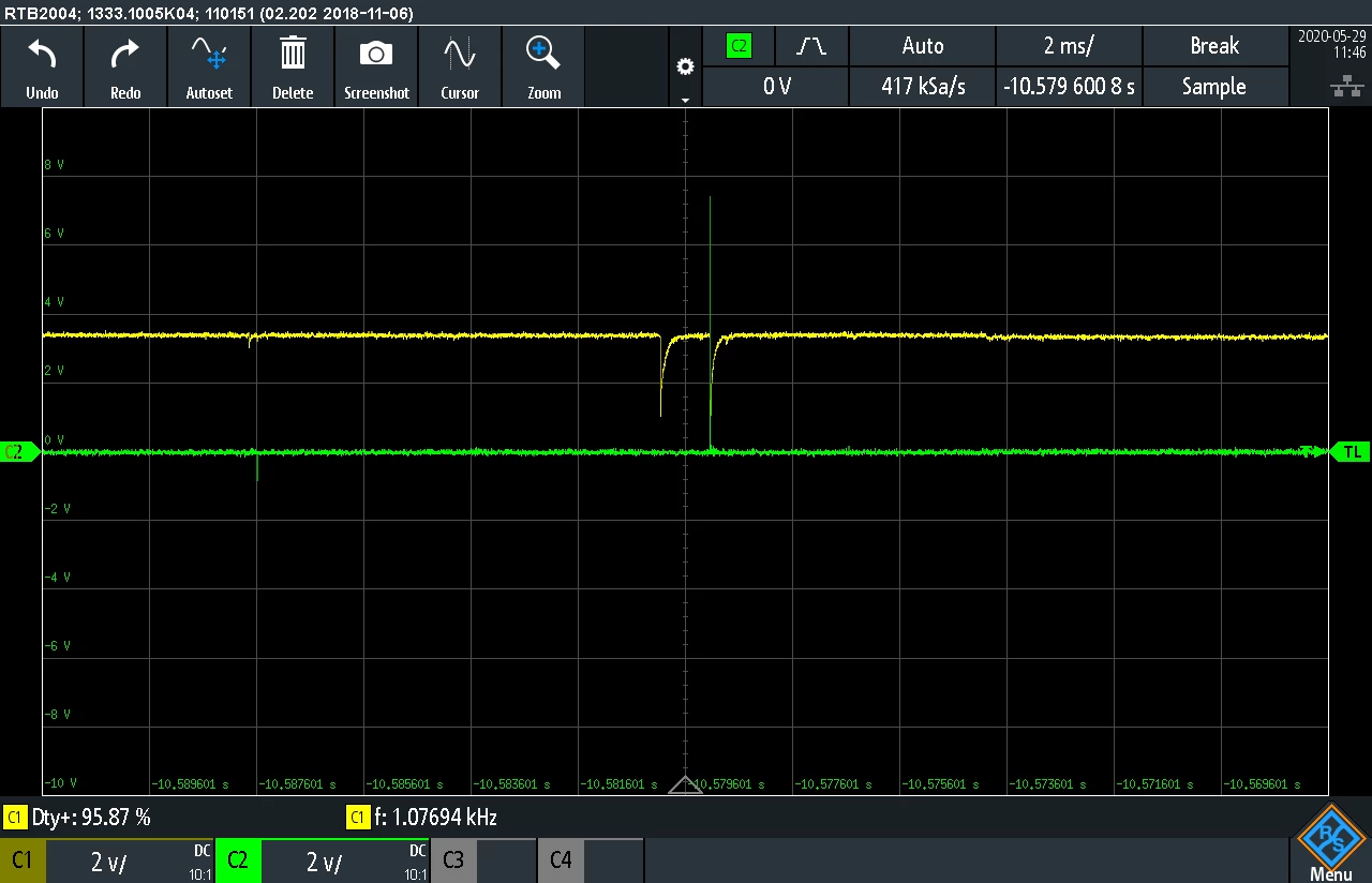

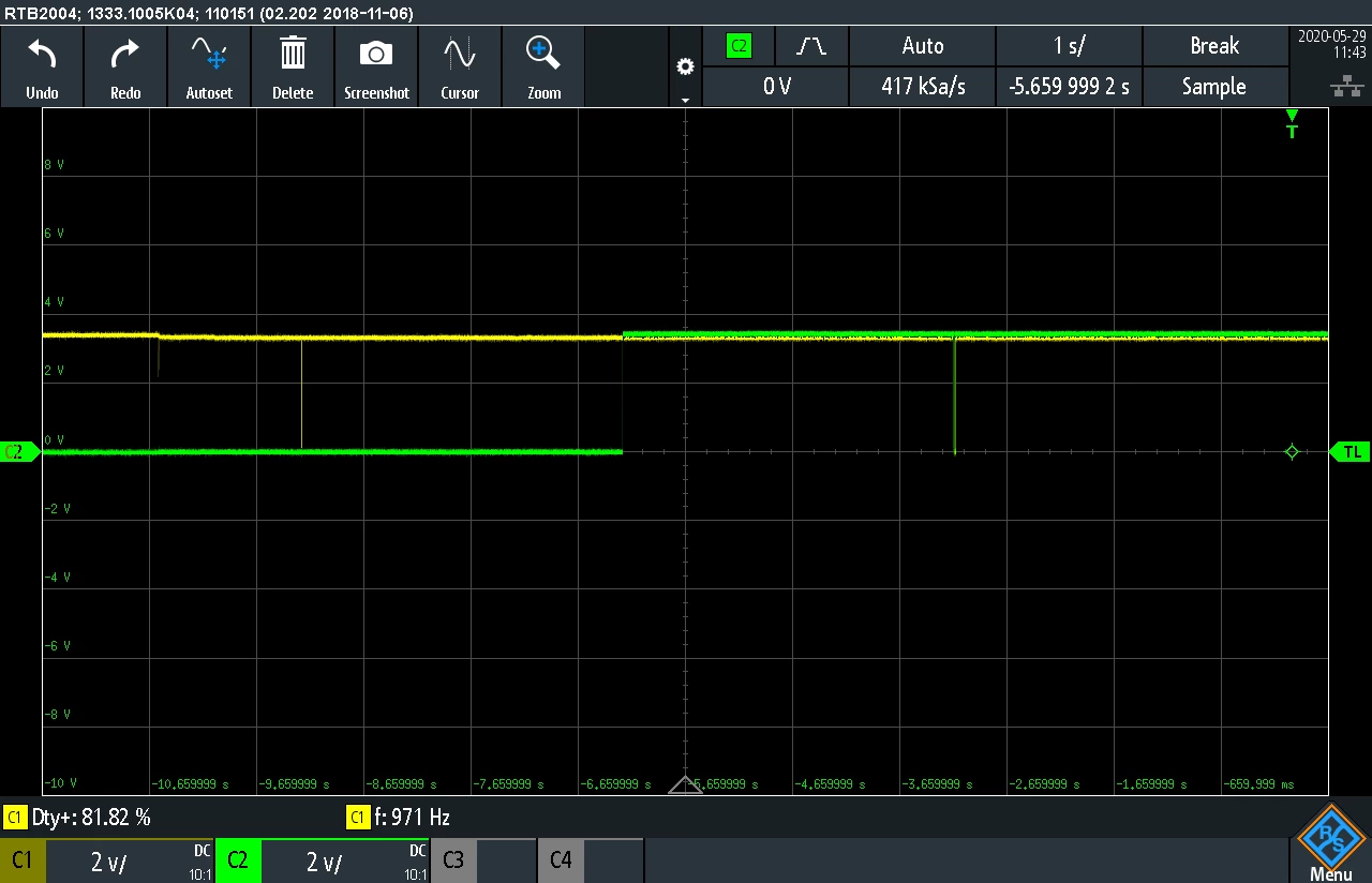

I don't got a logic analyzer at home due to quarantine so here is what I got.
I didn't catched an error after 500 retries but I got this at startup. The signal goes down of 2V during 250µs.
It is how it is represented with startup, delay and my normal frame.
I still don't know if it can be enough to generate fake messages in some cases.
