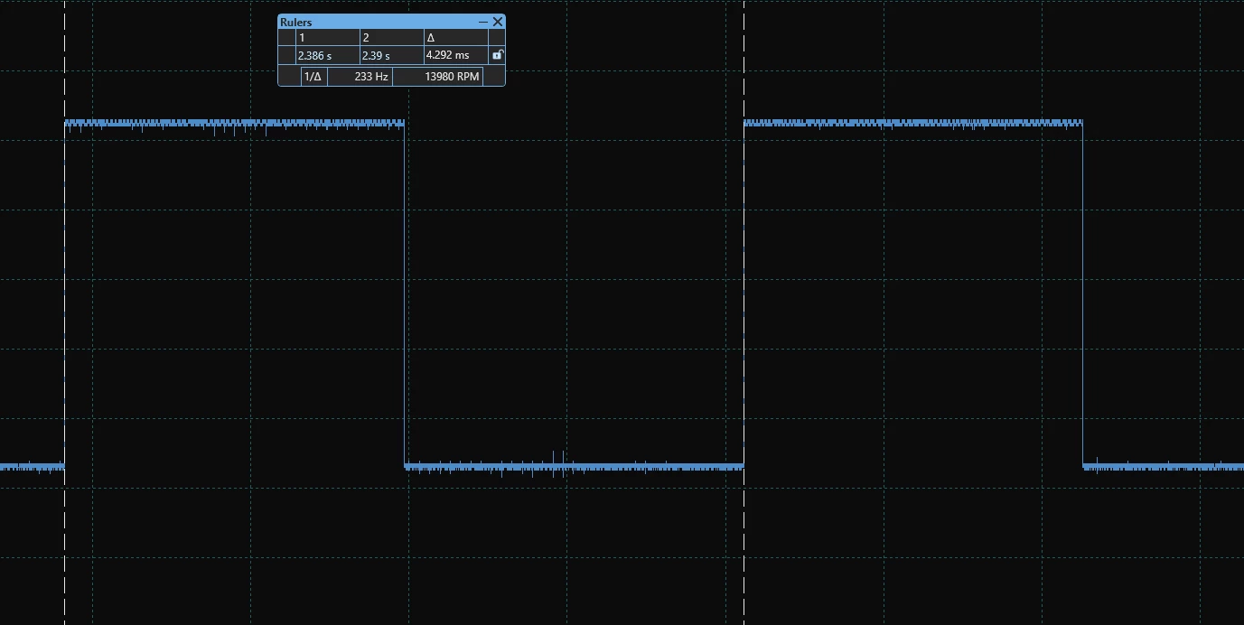

I am setting up Timer 1 channel 3 on the STM32F4. I am looking to set up a period of 3.9ms or 256kHz. I am using ABP1 - 168kHz, the ARR is set to 65535, and a prescaler of 10.
65535 / ( 168,000,000 / 10) = 3.9ms
My timer initialization is below.

I have confirmed that the configuration registers do not change after initialization. I would expect to see a 3.9ms period, I consistently measure a period of 4.3ms with my scope. The only way I can get a 3.9ms period is altering the prescaler to 9 instead of 10. I do not understand why this is happening and what configuration within the timer controls this. This issue is independent of the CCR register.
This scope captures the signal at a 50% duty cycle and the configuration shown above. I am quite lost on why this is happening.

The correct equation is:
(ARR+1) / ( 168,000,000 / (prescaler+1) ) = timer period
So with ARR=65535 and prescaler=10 you should get 4.29ms.
