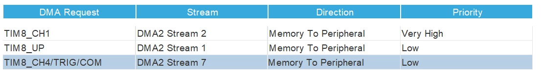

Hello Team,
I am using the STM32F469NIH6 to implement a timer triggered DMA and I need some clarity on a few points here-
I see that that there are three possible requests possible for a timer triggered DMA. I understand that the TIM8_UP is to trigger a DMA request with an update event (which occurs when the counter overflows/underflows)
What is the TIM8_CH4/TRIG/COM all about? How is it different from the TIM8_CH1 request?  Any leads on this would be of help !

waclawek.jan
May 23, 2024
> TIM8_CH1 request
That's triggered by a Capture or Compare event on TIM8_CH1, if TIM8_DIER.CC1DE is set.
> TIM8_CH4/TRIG/COM
That's triggered by one of the Capture/Compare on TIM8_CH4, or the Trigger event (i.e. edge of TRGI signal as selected by TIM8_SMCR.TS), or the Commutation event (that is a rarely used event I am not going to discuss here); again, if respective DMA-enable bit is set in TIM8_DIER.

Hi @waclawek.jan ,
Thank you for your response.
I am trying to operate timer 8 in ETR Mode (in slave trigger mode) and I have enabled TIM8_CH1 DMA request for the same (Master TRGO OC mode). I am supplying an external PWM signal to the respective ETR pin allocated for timer 8.
Upon configuring this, when I probe the ETR pin, I see that my master signal that I apply is getting corrupted.
Am I missing out on any configuration here?

waclawek.jan
May 24, 2024
Which pin is that?
What hardware is this, your own, or some "known good" board like Nucleo or Disco?
Read out and check/post content of timer and relevant GPIO registers.

@waclawek.jan
PA0 is the ETR pin that I am using for TIM8_CH1
I am using the SDP-K1, which has an STM32F469NIH6 mounted on it.
The timers and the GPIOs seem to be configured right.

waclawek.jan
May 24, 2024
Yet you complain about a timer-related pin working strangely.
How else do you propose to debug it? The mcu works out of its registers, not out of source code or CubeMX clicks.
