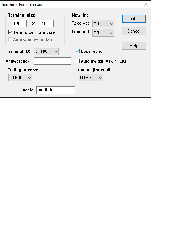

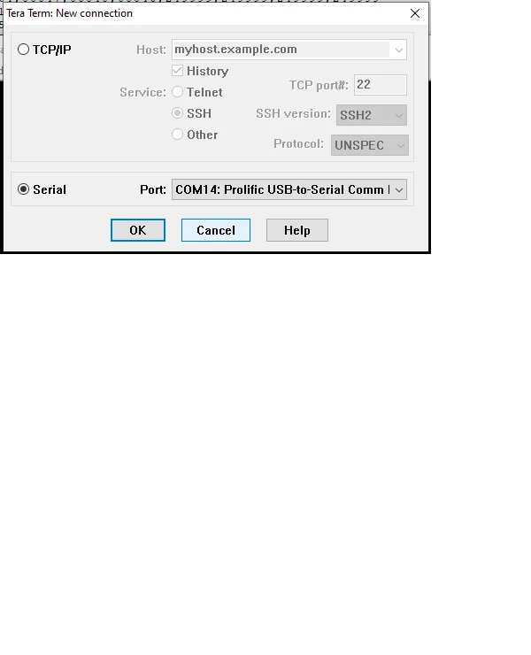

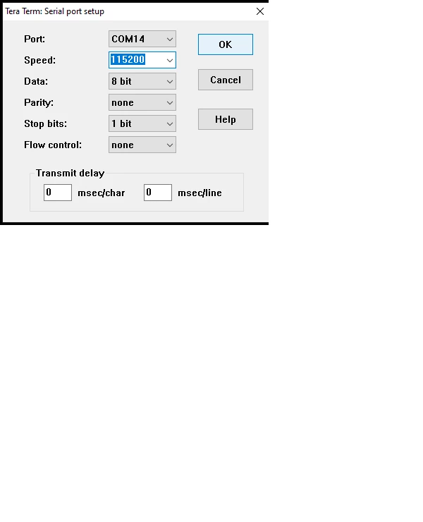

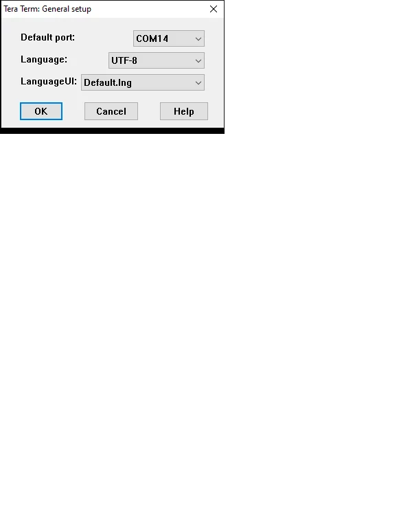

stm32f4 teraterm
I want to use teratern to send a string to my usart on stm32f4, but nothing is received.
these are the settings of my teraterm
Piranha
PiranhaBest answer
Principal III
Feb 18, 2020 10:36 AM UTC
UART is a stream (not message) based protocol. You can't assume that your message is at the beginning of received data block.

Ozone
Principal
Feb 10, 2020 12:26 PM UTC
Assuming the F4 discovery, it has a V2.0 ST-Link, without VCP link to the target.
So, do you see any output from the F407 Tx pin ?
Did you check the connection (F407-Tx to PC-Rx) ?
For a serial connection to a PC, you need a level converter to at least 5V. The 3.3V of the MCU Tx is not sufficient.

Principal
Feb 14, 2020 7:57 AM UTC
> My problem is that Hterm hangs when I want to use it for a data stream.
> The data stream is shown on the Tere term, but I can not take any USART Receive data.
It's not clear to me what you mean here.
But according to the screenshots, hterm operates in VT100 mode, i.e. it emulates the behavior of a old mainframe terminal.
Those therminals used to operate line-based, not character-based.
Try setting it to a raw mode, without any character preprocessing or interpretation.
I'm using Linux for such stuff, not familiar with HTerm. I had worked with PuTTY once, which has such a raw mode.
Piranha
Principal III
Feb 18, 2020 10:35 AM UTC
Screenshots are from Tera Term and basic text printing should work in VT100 mode also.
