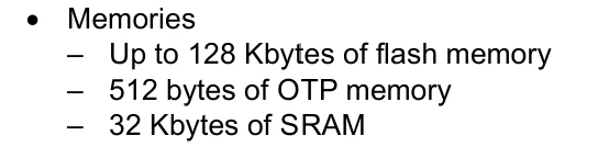

Oct 1, 2026 4:08 AM UTC
There is no ROM in the datasheet description. Do you mean OTP memory?
sschirberAuthor
Oct 1, 2026 4:34 PM UTC
Using the system memory bootloader ROM which is used for booting from uart mentioned here:
I think this is different even from the memory mentioned here
