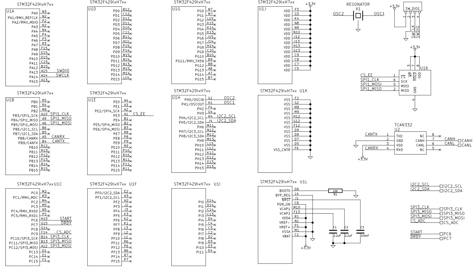

Posted on March 29, 2018 at 17:23
I am using a STM32F429IG, but I am having some difficulties at elevated temperatures.  Much above 70 DegC the program just seems to stop.  I have decoded the internal temperature as well as using an external one, so I an happy the temperature is correct.  Any ideas, anyone, as I'm starting to run out.

    I am adding my schematic for info, could this be something to do with the internal regulator..?

    Ah so it's BGA? Can't this simply be a case of bad joints on some of the supply/ground pins? Do you have multiple pieces of hardware exhibiting the same symptom?
    Also, can't the 'resonator' be a source of temperature-dependent issues?
    To be honest, I'm not exactly sure what it is doing.
    So how does it fail short of expectations and what those expectations were? In other words, how do you know it 'stops running'?

    Posted on March 30, 2018 at 12:21
    I have tested 3 pieces of hardware all exhibiting the same fault - 2 have been professionally fitted, and 1 by me!  The resonator is specified to 125C, at 0.1%, so I don't suspect that - and I have used it in the past on STM32F103's without issue.  I'm currently playing around with :
    __HAL_PWR_VOLTAGESCALING_CONFIG(PWR_REGULATOR_VOLTAGE_SCALE1);
    //settings,
    Clive also mentioned FLASH LATANCY settings, but not sure what impact this will have on temperature...
    Here is my full config...

    The oscillator circuit is an analog thing, it may go awry with temperature-induced changes in its parameters - including the amplifier internal in STM32. In other words, the component may be good to 125deg.C but the oscillator as a whole system may fail.
    What's it frequency? What's the system frequency? How do you use the Q tap of the PLL?
    And you still haven't answered the main question, what are symptoms exactly and why do you think it's a failure?

    All sorted.  I set
    instead of:
    __HAL_PWR_VOLTAGESCALING_CONFIG(PWR_REGULATOR_VOLTAGE_SCALE3);
    And it runs all the way up to 125C now.
    I'm guessing when I used the CUBEmX tool to generate the code automatically, I originally had a lower HCLK (100MHz) and it set the internal VREF to too low a value...
    Thank you for your assistance.
