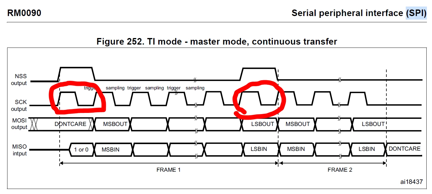

> Issue is when the NSS is high, Clock also present.
The "NSS" signal on the STM32F4 is not a CS signal. It pulses at the end of each byte in TI mode, which is presumably what you have selected. You'll need to use a different method.

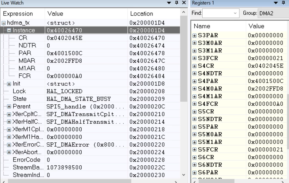

JohnsAby
JohnsAbyAuthor
November 15, 2021
Hi TDX,
Thanks for the response.
MX_DMA_Init is done before MX_SPI_Init
DMA2 Stream 4 and SPI5 is used.
please find the above images attached.
November 15, 2021
The DMA stream isn't enabled. Might be some flags set in DMA2_HISR.
Since NDTR=0, it could be that the transfer is complete, but you don't have the DMA transfer complete interrupt implemented or handled correctly, or interrupts are disabled.

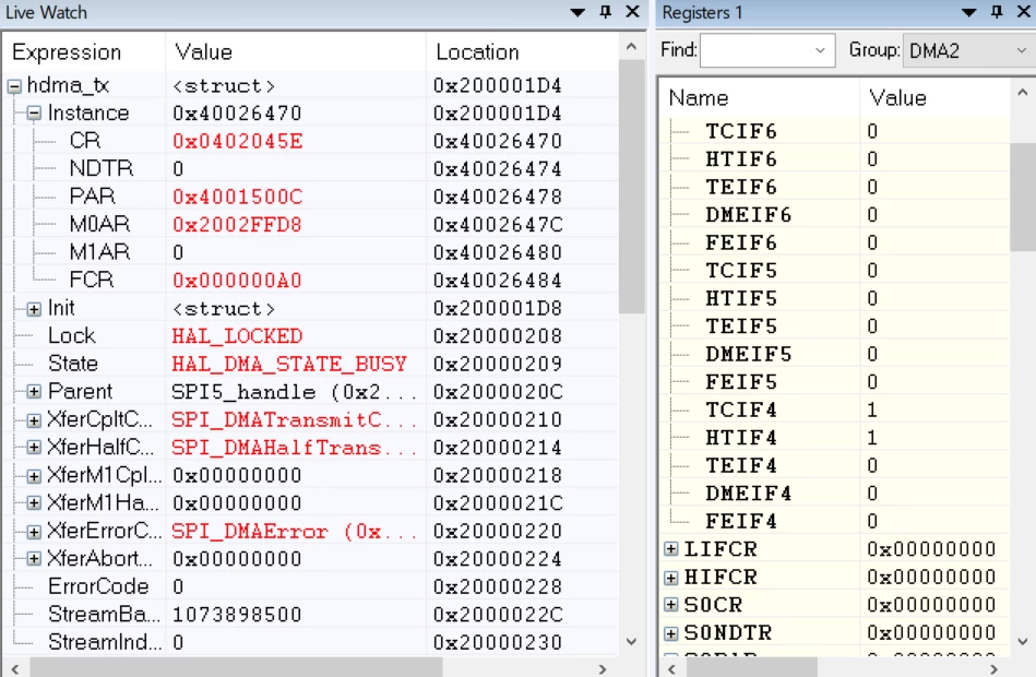

JohnsAby
JohnsAbyAuthor
November 16, 2021
0693W00000GXj7qQAD.pngHi TDK,
DMA stream is Enabled and TC and HF bits in HISR are getting set after Transfer.
NDTR is getting populated during transfer.
Still then
_inline_ static void spi5_dataTransfer(uint16_t *TxBuffer)
 HAL_GPIO_WritePin(SPIx_NSS_Port, SPIx_NSS_Pin, GPIO_PIN_RESET);
 HAL_SPI_Transmit_DMA(&SPIx_handle, (uint8_t *)TxBuffer, 8u);
 HAL_GPIO_WritePin(SPIx_NSS_Port, SPIx_NSS_Pin, GPIO_PIN_SET);
 while (HAL_SPI_GetState(&SPIx_handle) != HAL_SPI_STATE_READY);
the control is not stopping at while(mentioned above).
And SPI state remains in "HAL_SPI_STATE_BUSY_TX" state.
Please help me to understand, what made you think "but you don't have the DMA transfer complete interrupt implemented or handled correctly, or interrupts are disabled".
Kindly reply, its helping me to understand more.

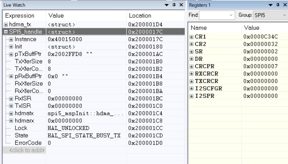

waclawek.jan
November 16, 2021
You appear to try to use SPI with CRC, is it intentional?
Do you use C++?
JohnsAby
JohnsAbyAuthor
November 16, 2021
Hi JW,
I use C language.
My SPI is configured without CRC (SPI_CRCCALCULATION_DISABLE)
waclawek.jan
November 16, 2021
Sorry I misread the bits in SPI_CR1, indeed, you don't have CRCEN set (rather, BIDIMODE and BIDIOE).
November 16, 2021
Since TCIE is set and TCIF is set, and the cpu isn't jumping into the handler, the corresponding NVIC enable bit isn't set, interrupts are disabled, or a higher priority interrupt is being ran.

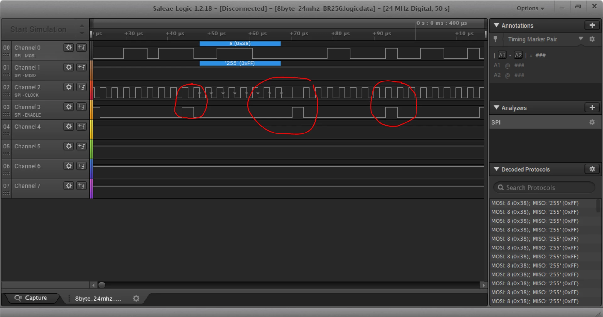

JohnsAby
JohnsAbyAuthor
November 18, 2021
Hi TDK,
You were correct about the interrupt,
For testing purpose, I changed to flow and called HAL_SPI_Transmit_DMA from main().
It worked fine for single byte transfer.
But when I pass multiple bytes( like 8, 25 etc) for last byte in the sequence is getting identified
 Please see below, Here data send are "12345678", but only 8 is identified(Data from 1-7 also present in transfer but during the ChipSelect high clock is present)
another example if "ABCDEFGH" is send means H will be identified.
Note: HAL_GPIO_WritePin(SPIx_NSS_Port, SPIx_NSS_Pin, GPIO_PIN_SET); is called inside HAL_SPI_TxCpltCallback() and is fine.

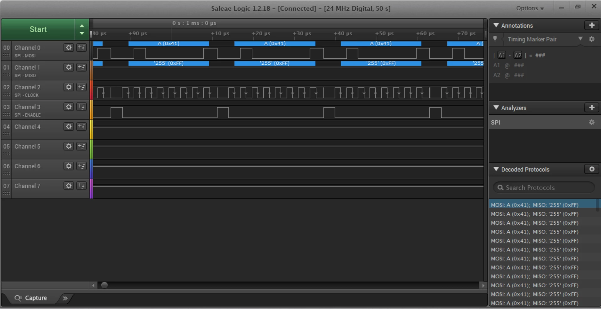

JohnsAby
JohnsAbyAuthor
November 18, 2021
Hi JW
Thanks for the quick response
I pass
uint8_t aTxBuffer[] = "ABCDEFGH";
to this
void spi5_dataTransfer(uint8_t *TxBuffer)
 HAL_SPI_Transmit_DMA(&SPIx_handle, TxBuffer, 8u); //8u //1u
waclawek.jan
November 18, 2021
> //8u //1u
Was the lower waveform (with red circles) taken with 8u or 1u?
And channel 3 displays the SPIx_NSS_Pin?
TDKBest answer
November 18, 2021
waclawek.jan
November 18, 2021
Nice catch, TDK!
Indeed, CR2 is 0x32 i.e. FRF is set.
In that case, also CR1.SSM is moot.
But this also implies that given pin is set as AF, rather than Out, in GPIO - is this the case?
