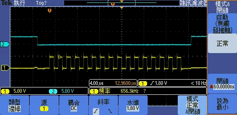

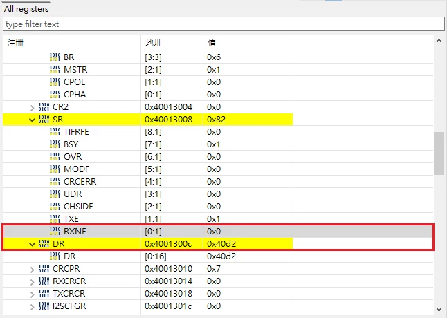

When I use a slower SPI frequency, both the timing and the data are correct.
If SPI Config hspi1.Init.BaudRatePrescaler = SPI_BAUDRATEPRESCALER_128:

RXNE Reset & DR Data is Correct
Blue is CS, Yellow is SCK

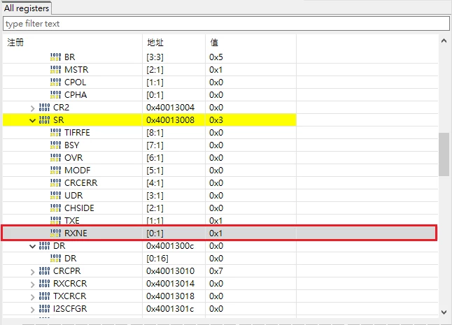

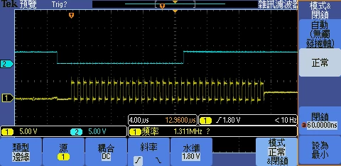

However, when I set the SPI frequency to be faster, errors occur.
If SPI Config hspi1.Init.BaudRatePrescaler = SPI_BAUDRATEPRESCALER_64:

RXNE no Reset

The (full text of the) errata you reference just says in 2 line RX only mode, ignore the BUSY flag.  The HAL F4xx library does that.  At least in CubeF4 1.26.1.
It looks like the HAL_SPI_Receive() code doesn't disable the SPI port fast enough when the clock divisor is 64.  Kinda hard to believe.  What is your SYSCLK frequency?
I have no experience with "master receive only" mode.  I've seen lots (several?) comments on this forum that people have not been able to get the the 2 wire master RX only mode to work.  The suggested solution is usually to configure the SPI in normal 3 wire (sck, mosi, miso) mode, then manually re-configure the MOSI (i.e. TX) pin as general GPIO or whatever other function you need.  Then the HAL_SPI_Receive() function just calls HAL_SPI_TransmitReceive().  In that mode, the transfers are triggered by a write to the SPI DR instead of "keep receiving until I disable the port" in RX ONLY mode.
August 6, 2024
Receive-only mode puts the clock in free-running mode which means you have a race condition between disabling the SPI and the clocks coming out.
I'd recommend using 4-wire mode with HAL_SPI_TransmitReceive and leaving the MOSI pin disconnected if you cannot allow the extra clocks.
