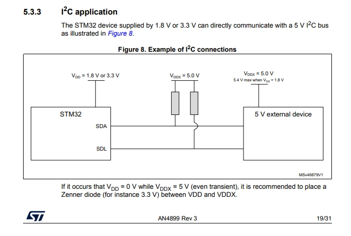

Sorry, I have another question to ask everyone. I'm currently using the Nucleo F429ZI with SPI interface to receive 12-bit encoded data from another ADC. The Vdrive of that ADC can provide 3.3V or 5V for driving. However, the high level of the STM32F429ZIT6 is 3.3V. If I want the SPI high level to be 5V, what methods can I use to achieve this?
Originally, I was researching GPIO's Open Drain to use an external 5V to accomplish this, but in CubeIDE, the SPI is set to Push-Pull. So I would like to ask, when using STM32, how can I achieve a 5V high level if the SPI requires it?

Hello @Scarlet ,
It's possible to setup the configuration described and speaking about 5V tolerant pins only in input mode.
When the output mode is enabled, the GPIO is no more 5V tolerant.
It could work based on next principle for I2C. Taking into consideration that problematic could be difference between VDD and VDDx, which should never exceed 3.6 V:

Hi @Imen.D,
Originally, I planned to use the Open Drain method to provide external 5V, but in CubeIDE, the SPI setting is configured as Push Pull. I cannot guarantee that when outputting a high level, the 5V won't flow to the STM32 VDD 3.3V.

Open drain and about 50 Mhz is probably no good combination, either current hungry  or with bad waveforms.
