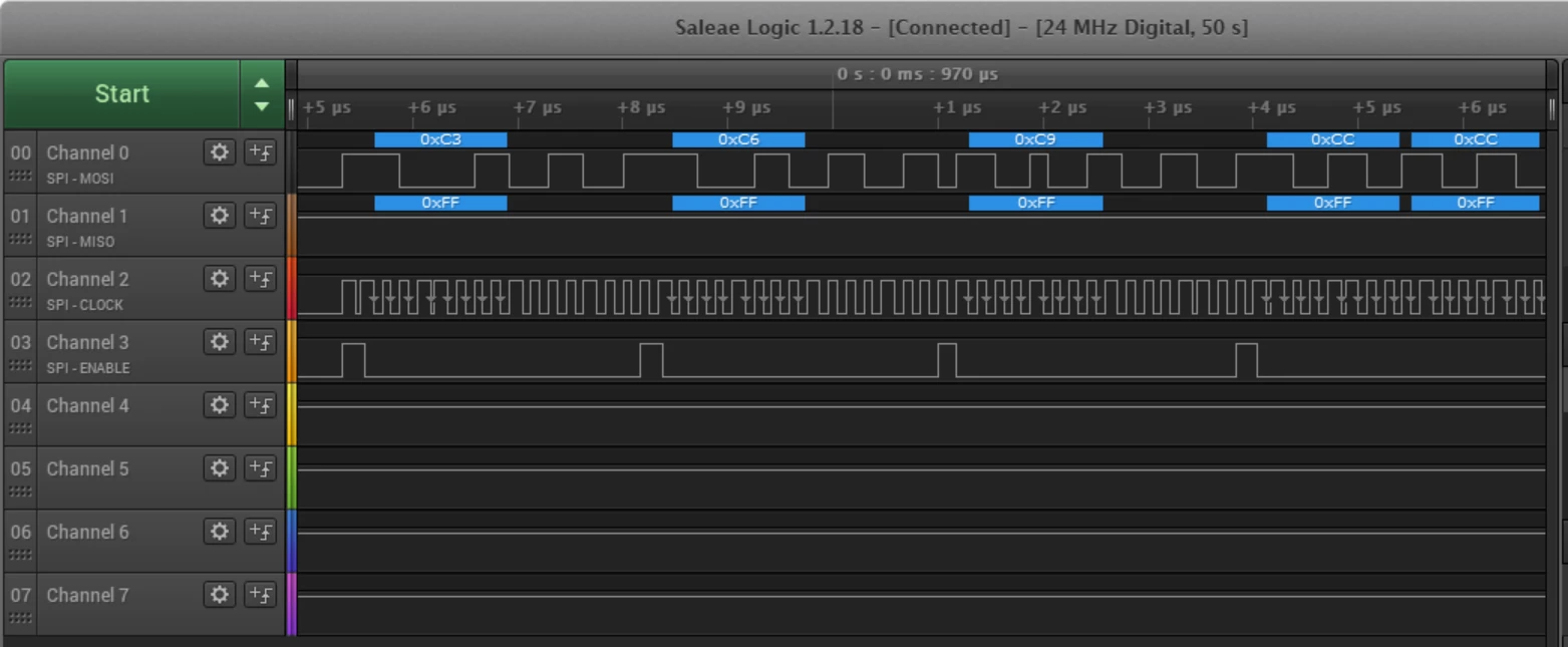

STM32F4 SPI-DMA with daisy chain not working. Problem with NSS signal.
I have done an SPI transfer only with DMA and working fine, but when I need to do a daisy chain configuration its not working. I am suspecting the NSS signal.

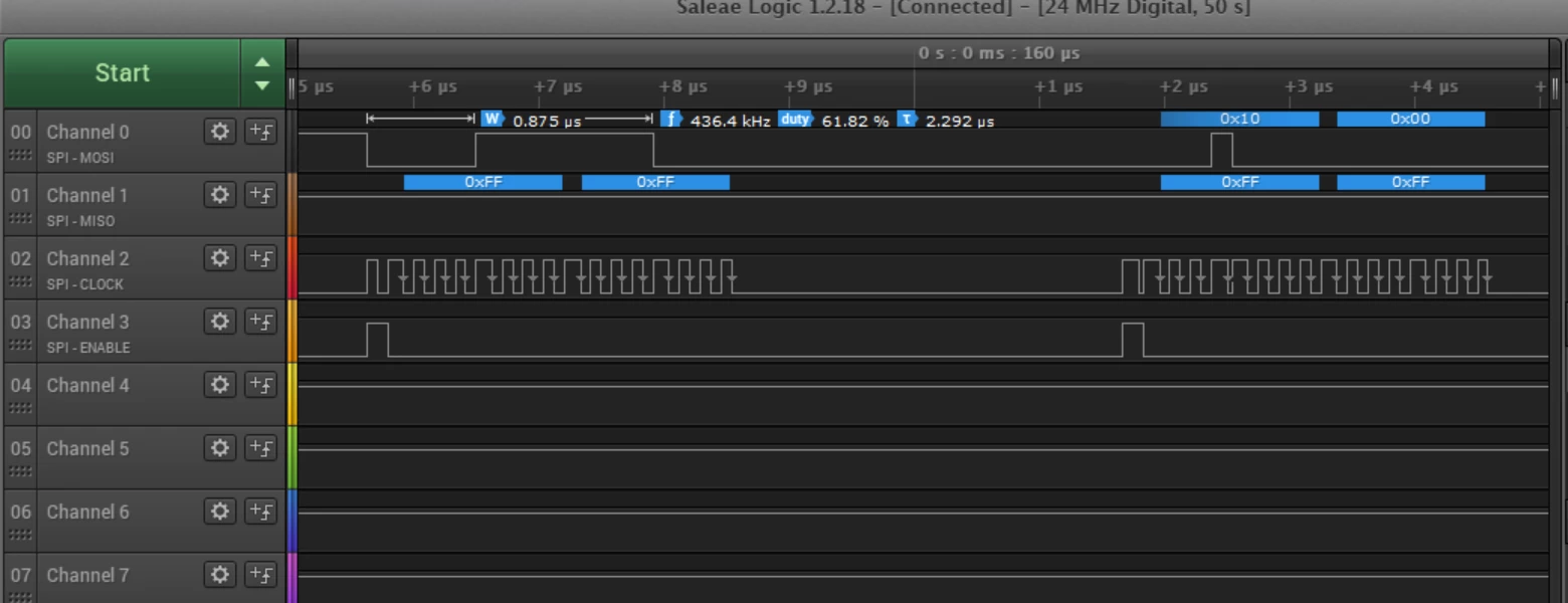

Without Daisy, waveform(below)
With daisy waveform(below)
0693W00000GYzZZQA1.pngin the above picture NSS is coming in between.

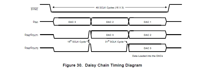

please help to achieve like below

NSS is not a CS signal. In TI mode, it is high for the first byte in a transfer. Since your data size is 16 bits, it is high for the first bit, then low for the remaining 15 bits. This isn't what you want.
Set up the SYNC signal as a GPIO output and control it manually. Set it low before each transfer and high after.

Disabled TI mode and GPIO is used to control the NSS signal (manually).
This solved my issue.
