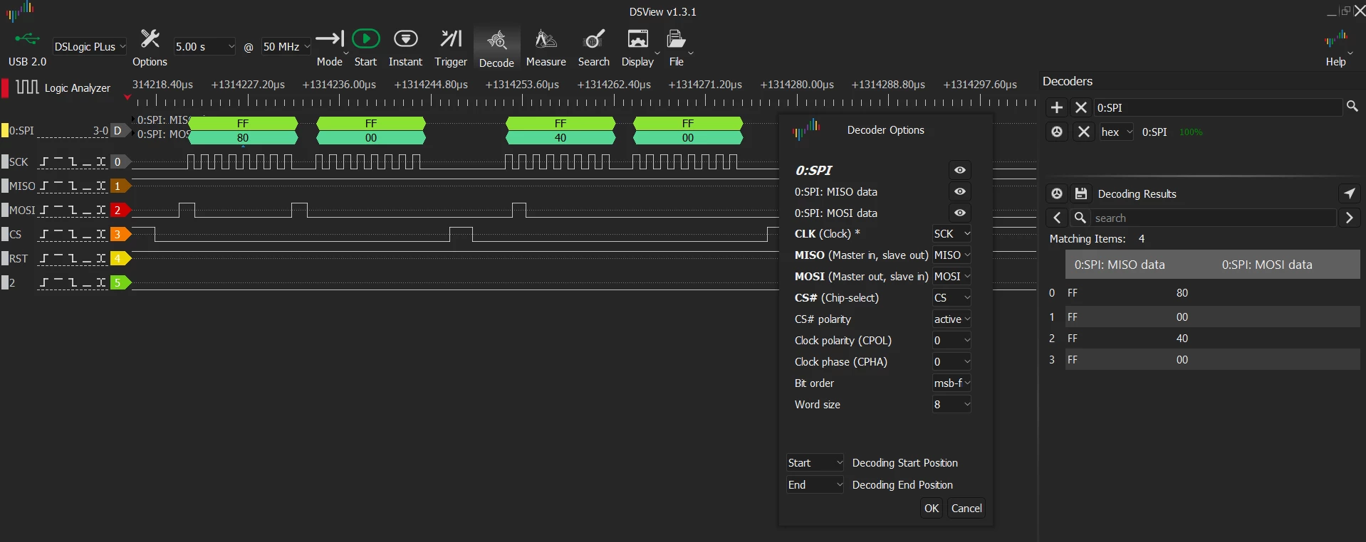

I'm trying to port Adafruit's RA8875 Arduino library to work with an STM32F4 Discovery board. The SPI communication is failing during device initialization.
During initialization, when reading the device ID register (0x0), I expect to read 0x75 but always get 0xFF. The SPI DR register gets set to 0xFF on the first transfer and never changes.
1. Is my SPI configuration correct for the RA8875 (Mode 3, ~1.3MHz)?
2. Could the issue be with my SPI transfer implementation?
3. Are there any timing requirements between CS toggles and data transfers?
Hardware setup:
- STM32F4 Discovery Board
- Adafruit RA8875 Display Controller
- SPI1:
- SCK: PA5
- MISO: PA6
- MOSI: PA7
- CS: PA4
- RST: PB0
I've tried various SPI modes and baud rates as well as adding delays between transfers and confirmed the wire connections are correct.

uint8_t x = readReg(0);
if (x != 0x75) {
Error_Handler(); // This is where failure happens
return false;
initialize();
return true;
}## SPI transfers ##
void Adafruit_RA8875::writeReg(uint8_t reg, uint8_t val) {
writeCommand(reg);
writeData(val);
uint8_t Adafruit_RA8875::readReg(uint8_t reg) {
writeCommand(reg);
return readData();
uint8_t Adafruit_RA8875::readData(void) {
_cs.write(GPIO_PIN_RESET);
_spi.begin();
_spi.transfer(RA8875_DATAREAD);
uint8_t x = _spi.transfer(0x0);
_spi.end();
_cs.write(GPIO_PIN_SET);
return x;
