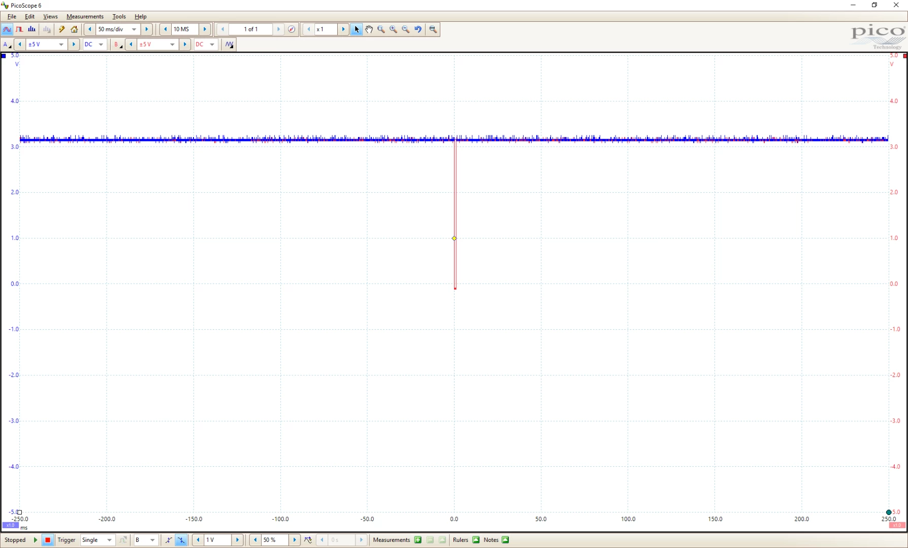

I have a Nucleo64-446RE and every 5/10 minutes the board resets itself.
I'm using the Virtual COM to send data to my PC and plot it (among many other things), and when the board resets I lose the Serial connection. I need to re-open it in order to plot again. If after this reset I want to program the microcontroller I get the ''Unable to reset target'' message for which I need to unplug and replug the USB(which is also powering the board). I'm using the System Workbench for STM32.
Here's an oscilloscope picture of the NRST pin (blue), which confirms the reset. The red trace is a 3.3V pin, which shows there are no power issues.
Can you please help me debug this reset?

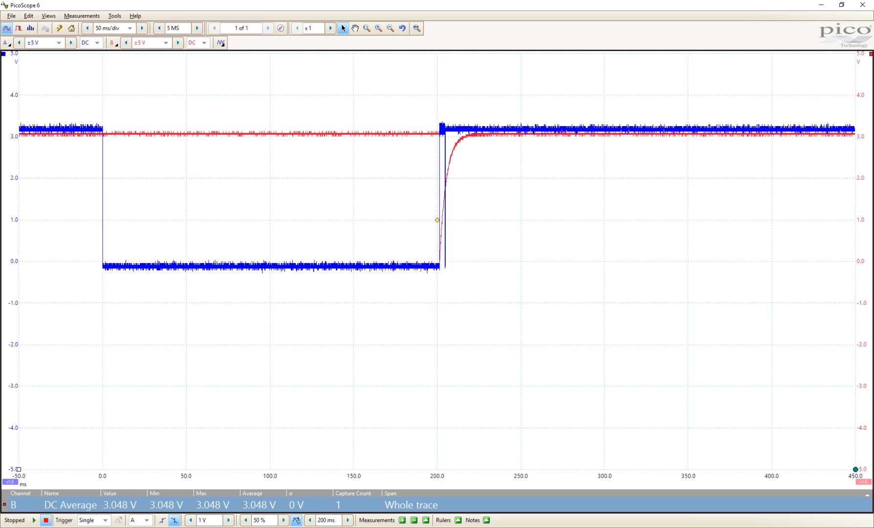

As I understand, it can't be a Hard Fault because (I think) in that case the system wouldn't reset but end up in an infinite loop. I haven't implemented any of the error handlers, but I think they're implemented by default with weak attributes.
Watching the following image:

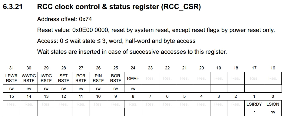

    Regarding the reset register:
    Reset value is not entirely clear.
    I understand I should read this register and then clear it with the RMVF bit. Then after the system resets itself I should see PIN + any other flag. And if I see only PIN, then it's the ST-LINK. Does this sound correct?

    Inspecting the RCC_CSR register the value I was getting (after a lot of trial since the debugger stopped working so I had to do it with the LED) was 0x14000000. This means Pin Reset + Soft Reset.
    So, only chance left is that they're connecting through the Serial Wire Debug. Either the ST-LINK senses a problem and then tries to reset the target MCU (which has some problem that causes a Soft Reset), or the ST-LINK is sending a Reset Command.

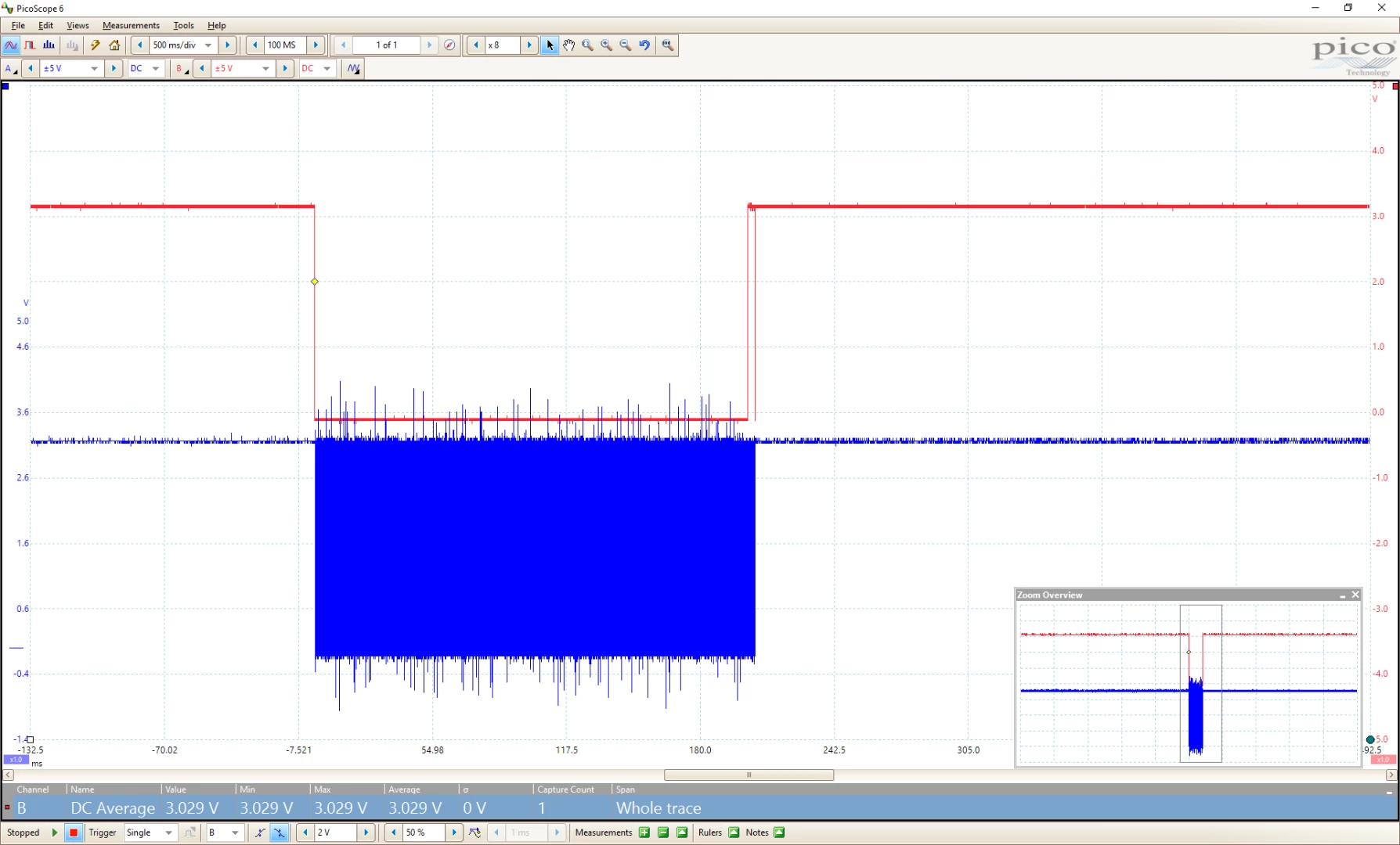

    I take a look at what happens with the T_NRST and the SWD Clock signal.
    When ST-LINK is trying to reset the target MCU, there's some communication going on in the SWD interface. This would confirm what was thought previously.

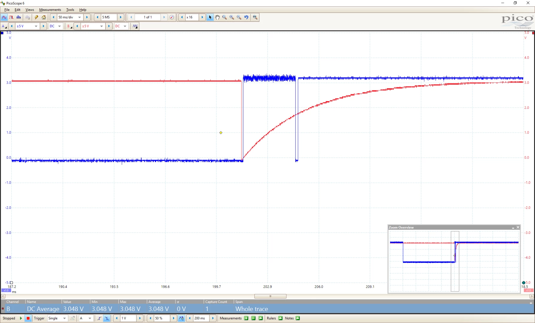

    After this I disconnected the SWD Clock and Data I/O from the target MCU. Red is T_NRST and blue is the NRST from the MCU.
    The ST-LINK tries to reset the MCU but now it has no way. It was sending a Reset command through the SWD and also using the T_NRST pin.
