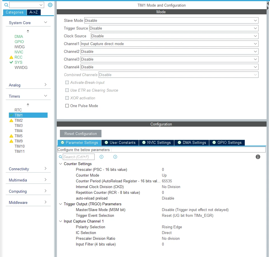

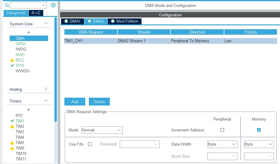

LOliv.2
LOliv.2Author
November 23, 2020
Nice, makes sense thanks. Would never occurred me to take a look at first figure if the manual. Now I guess that Figure 23 could also be valid to understand this fact.
I will now share my configuration for a sample demo that captures 8-bit data from GPIOC pins 0-7 when a button connected to TIM1 channel 1 in Input Capture mode (also called Compare in TIM1) is pressed. The program sends through UART the data nicely formatted. When the serial transfer is complete a UART TransferComplete interrupt enables again DMA for a new transfer.
A couple of quirks: if the timer is used just as a mean to trigger DMA or a IC interrupt, it doesn't need to have the clock enabled. Another maybe strange thing is that DMA is configured to move bytes, while the GPIOC IDR register is 32 bit, although 16bits are reserved. The motivation of this choice is that in my application I can use the first 8 contiguous pins as in input. This allows me to use a receiving buffer of bytes, saving memory.
