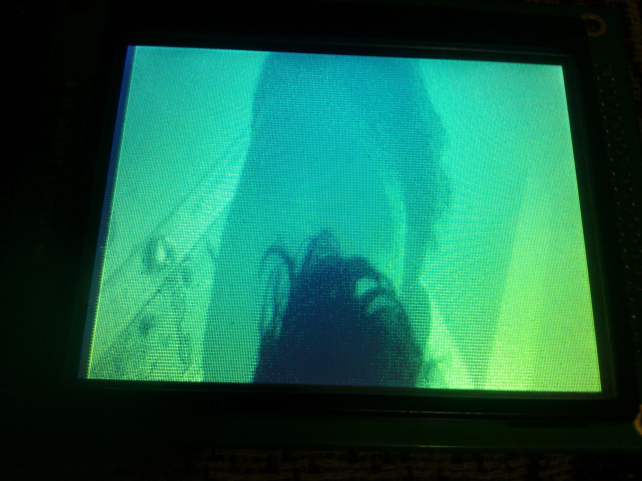

i am working on a project with stm32f4 , ov7670  and dm-lcd35rt image output from my camera is doubled and also its colour is greenish  following is my register setting
// Clock Settings // xclk 24M pclk 12M
    {0x11, 0x00}, //
    {0x6b, 0x8a}, //
// check different
{0x3a, 0x08},
{0x3d, 0xc2},
  {0x12, 0x15}, // RGB processed  set + QVGA set
  {0x40, 0xd0}, // output range till 0xFF RGB-565 select
{0x3e, 0x11},
in snapshot mode it works fine but in continuous mode frame overlaps i cant work out why frames are overlaping in such way
on each vsync interrupt i set my lcd cursor to 0,0 apparantly it is not working this way following is my intterupt function

image from my lcd output is attached
can any one give me some directions about it?
