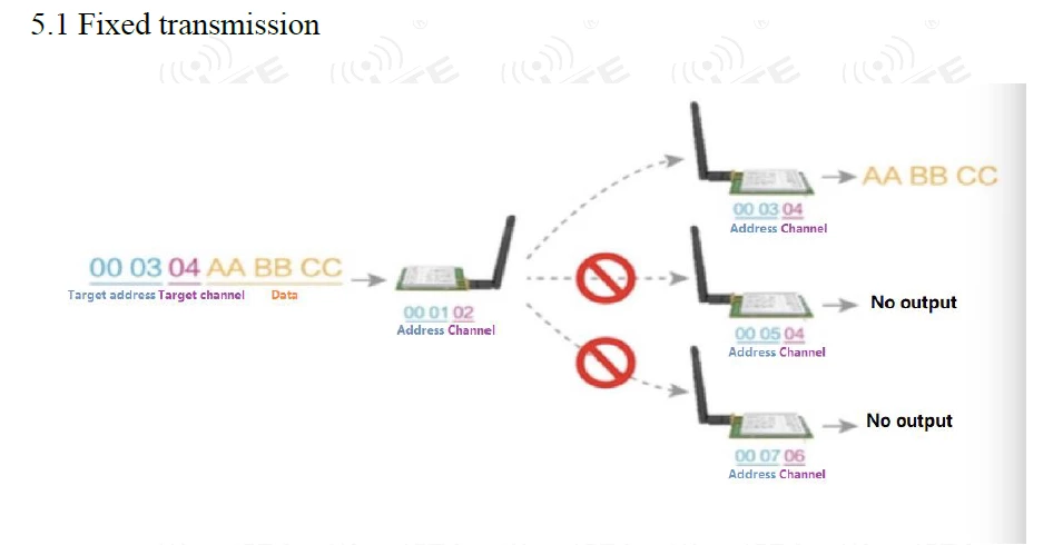

in the documents of datasheet it says : "in fixed mode..."
data[0] is 0x00 which is ADDR High
data[1] is 0x01 which is ADDR Low
data[2] is 0x32 which is Channel (410.125MHz + data[2]*1MHz = 460.125MHz)
so I am sending uint8_t data[5] = {0x00, 0x01, 0x32, 0x03, 0x03}; through to the E220 in tranciever board.

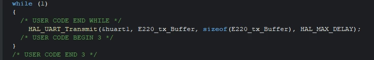

on the other side I am trying to read with 3 ways:
HAL_UART_Receive(&huart1, data, sizeof(data), HAL_MAX_DELAY);
HAL_UART_Receive_IT(&huart1, data, sizeof(data));
HAL_UART_Receive_DMA(&huart1, data, sizeof(data));
But I cannot read any data. What should I do?

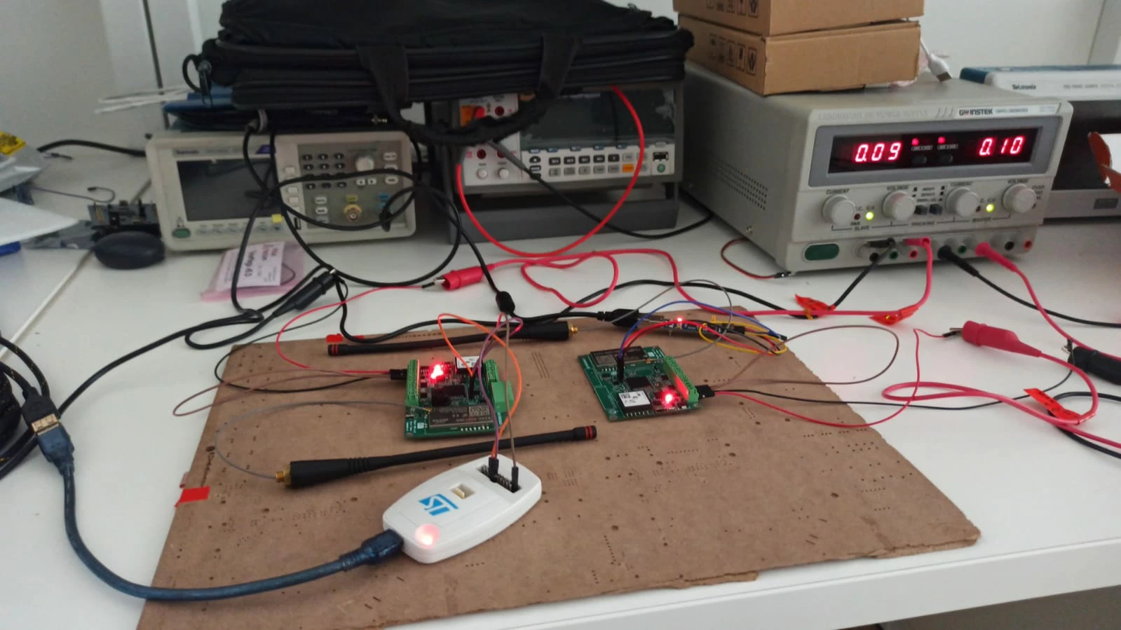

! I DONT HAVE AUX CONNECTION ON MY BOARD. AUX IS FLOAT"
Here is my test station. I got 2 boards with STM32F446VET7 and LoRa E220-400T30S & 2 410-480MHz antenna.
I tried fixed and tranmission modes seperatly but nothing changed. Still no data transcieve.

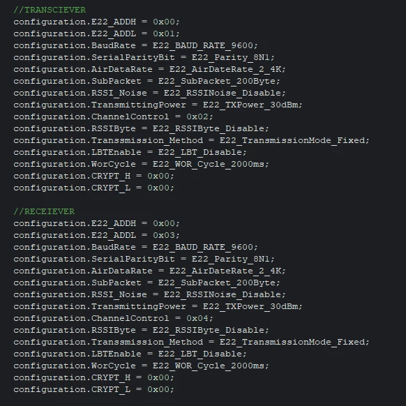

Here is my Transciever and receiever configuration for fixed mode:
and first three byte of data is ADDH(0x00) - ADDL(0x03) - CHANNEL(0x04) of receiever.
uint8_t E220_tx_Buffer[8] = {0x00, 0x03, 0x04, 0x0B, 0x0C, 0x0D, 0x0E, 0x0F};

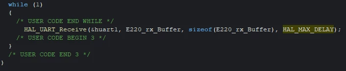

and the transmit & receive functions that I used in while loop :
Transmit :
Receive :

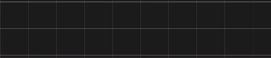

- Are your STM32 uart's working? Are they well configured? Can you send ascii characters to a serial terminal?
- Have you crossed the signals between the STM32 and the modules UART_RX to the E220_Tx and UART_Tx to the E220_Rx?
- Have you checked and visualized the Rx and Tx signals from one end to the other of your modules (with a logic analyzer or an oscilloscope)?
- Have you you visualized the AUX pins, do you see the waveform responses that you find in the user manual of the module (even if you do not use AUX)?
- Are your modules and STM32 correctly (sufficiently) powered, can you check your cards and your schematic?

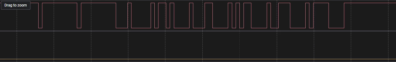

August 6, 2024
Hello Romain thanks for answering.
My UART are working. I can configure my device with that.
Yes I crossed RX-TX signals.
This is the transciever logic analyzer image:
RED is module RX pin which microcontroller TX.
Orange is AUX pin and it always LOW.
This is the receiver logic analyzer image:
White is module TX pin which microcontroller RX always high.
Brown is AUX pin and it always LOW
