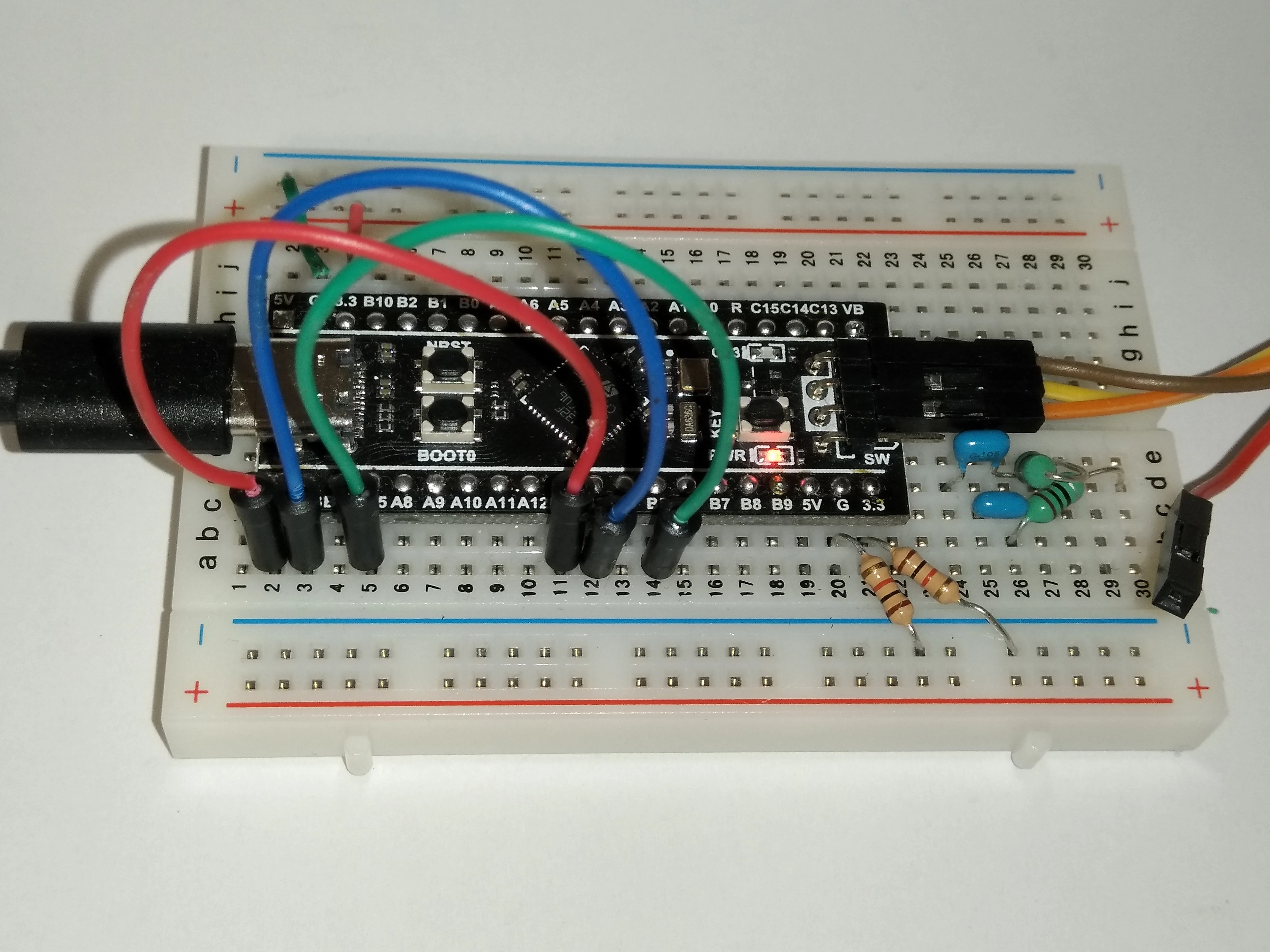

Sep 26, 2020 3:14 AM UTC
Dear Jan,
Thank you very much for your reply. Your comment is very encouraging.:smiling_face_with_smiling_eyes:
Unfortunately, I do not have Oscillo or Logic analyzer. But my test bed is very simple.
0693W000004HBbhQAG.jpg Therefore, I need check the received data.
In 16bit in 16bit data frame case, I thought loopback data (received data) is OK, but it was NOT.
Received data is unexpectedly SHIFTED. (see red part) [PDF attached]
And In 24bit in 32bit data frame, received data was DISASTROUS!!!
If you (and anyone!) have any idea what is wrong, please enlighten me.
Many many thanks in advance.
K.A.
KAJIK.1
KAJIK.1Author
Sep 26, 2020 4:10 AM UTC
One Correction.
I checked Device configuration again, and found an error in 24bit mode. (Assignment of SCK for I2S3 was not correct.)
However, received data was same as 16bit mode, that is, received data was SHIFTED. [please see PDF]
Please help!!!
