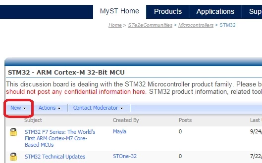

    Excuse me for being irrelevant, I'm new here and don't know how to create a new post! Can you guide me with that?
    Sign into forum
    Go to the ''STM32'' forum page, listing the threads
    Go to the upper left corner of the thread list, and click the ''New'' tab.
