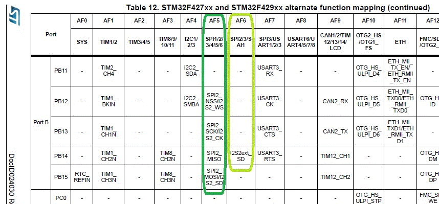

Hi all,
when configuring I2S2 on Pins PB14/PB15 (SDext/SD)  I encounter that no data is ever output on those pins.
When configuring PC2/PC3 as SD/SDext for I2S2 the data is output on that pins (but not on PB14/PB15). WS and CLK are configured on Pins PB9 and PD3.
The chip used is a STM32F427VGT6 (LQFP100) revision Y.
Can anyone confirm that issue? Within the errata or data sheet I couldn't find anything in regard to this.
Additionally: Does anyone use I2S and an ULPI phy on a design?
Thanks in advance,
bs

Be wary that PB14 as SDext needs GPIO_AF_SPI3 (6), not GPIO_AF_SPI2 (5)

yesterday I created a ''minimal example'' to reproduce the issue, with interesting results: basically if only using I2S2 on those pins (with other functionality disabled) it works.
I then checked back with my software (using USB HS with ULPI, I2C, etc. ) and found it not working (same configuration).
After I disabled the USB HS peripheral (configured as ULPI) the I2S started working....
PB14 and PB15 are as other alternate function USB HS DP and DM pins.
I assume: the DP and DM pins are routed directly to the USB HS peripheral, irrespective of using ULPI or the embedded USB 2.0 FS PHY and the state of the AF multiplexer.

Finally, no example, but a solution:
If USB_OTG_GCCFG_PWRDWN is set (thus transciever power down is deactivated) the DM/DP pins are driven by USB, irrespective of their function mapping.
USB_OTG_GCCFG_PWRDWN is necessary only when using the HS peripheral with the on board FS PHY.
It would be nice if such things would be mentioned anywhere.
