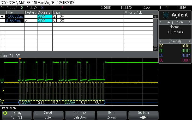

    markgilson9
    August 8, 2012
    Posted on August 08, 2012 at 13:34
    I still believe I am having issues with the I2C, specifically with the start and stop sequences.  Below is a screenshot of what I'm seeing.  The I2C address and data are definitely being acked, but Even though I have:
    I2C_GenerateSTART(I2C, ENABLE);
    I2C_GenerateSTOP(I2C, ENABLE);
    It doesn't seem like I'm seeing the start or stop.  As you can see there is a restart event between my messages, implying no stop.
    Any suggestions???
    markgilson9
    August 8, 2012
    Posted on August 08, 2012 at 17:51
    Actually, it appears the start is working, just not the stop.  Here's what I'm doing for my stop:
    I2C_GenerateSTOP(I2C, DISABLE);
    I2C_ClearFlag(I2C, I2C_FLAG_STOPF);
    /* Send STOP condition */
    while(I2C_GetFlagStatus(I2C, I2C_FLAG_STOPF)); // stop bit flag
