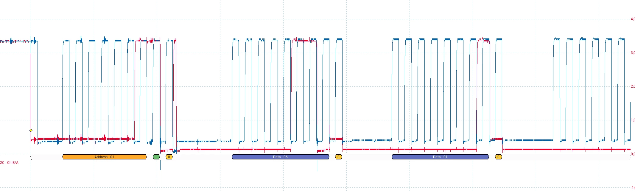

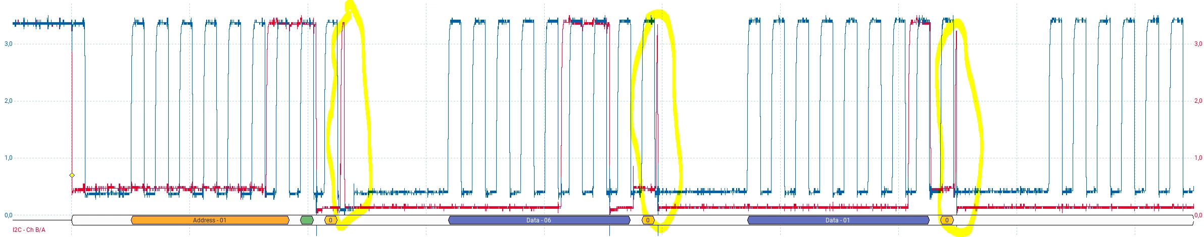

 I've noticed some spikes when the STM32 I2C controller generates the answer, see below (yellow markings)
Blue: Clock generated by the controller (the clock speed is about 200kHz)
Red: Adrdess Byte generated by the controller, Data Bytes generate by STM32 I2C transmitter (answer) with spikes
When the FREQ Bits of I2C_CR2 Register are zero, this spikes doesn't occur, see below

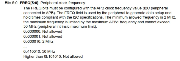

The Reference Manual RM0368 Rev 6 for the I2C CR2 writes:
It is noticed that this FREQ bits must be configured to generate I2C compliant Signals. Anyhow from EMC perspective this spikes are bad because the radiate a wide spectrum. I've found nowhere information of correct I2C specifiation/behaviour of the Data Signal the be compliant, anyhow the data is transfered correctly to the controller.
Q: must the FREQ bit of CR2 be set in slave mode?

A1/ CR2.FREQ is not only for master mode. On this peripheral, it is used by the hardware to derive internal timing thresholds and to make the signal behavior compliant with I2C requirements.
A2/ The controller must comply with : data setup time, data hold time, SDA valid around SCL edges, SCL timing, rise /fall time.

Can you check bus capacitance, PCB routing ? Check if spikes are real or measurements artifact. If it appears on SDA only when the slave is transmitting, the artifact likely concerns SDA transitions not SCL generation.

Hi FBL,
thank you for you clarification, spikes only appear in slave is transmitting on SDA transitions. Anyhow now the setup is working fine without any error or interruption.
