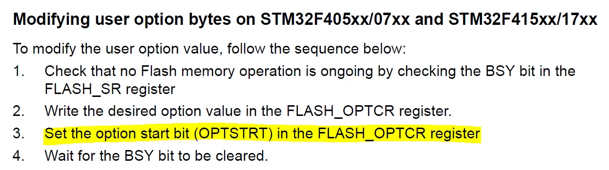

    Seems a lot of people have problems programmatically setting the ROP level, I tried using the default code on an STM32F407VGT6 and it doesn't use the 0xBB level to protect at level 1, but 0x55...but it doesn't work.
    Cube Programmer allows it to be set to 0xBB and that does work.
    So I tried 0xBB programmatically, and it still doesn't work.  Though set, after a reset the 0xAA value returns.
    Here is the code if anyone feels inclined to close this issue with a few lines of code that actually work:
     //FLASH_OBProgramInitTypeDef OBInit;
     //HAL_FLASHEx_OBGetConfig(&OBInit);
     if (*(__IO uint8_t*)(OPTCR_BYTE1_ADDRESS) != 0xBB)	//OBInit.RDPLevel != 0xBB)	//OB_RDP_LEVEL_1)	// This does not seem to work with STM32F407VGT6 clone board. Test with STM VGT6U.
     	 HAL_FLASH_OB_Unlock();
     	 OBInit.OptionType = OPTIONBYTE_RDP;
     	 OBInit.RDPLevel = OB_RDP_LEVEL_1;	// 0x55 (0xBB usually, version change?)	Prevent read of prog mem. Can be reset to 0xAA. 0xCC will blow fuses so chip can never to reprogrammed.
     	 HAL_StatusTypeDef result = HAL_FLASHEx_OBProgram(&OBInit);
     	 *(__IO uint8_t*)OPTCR_BYTE1_ADDRESS = (uint8_t)0xBB;	// Block prog. read back.
     	 HAL_FLASH_OB_Lock();
    Aug 12, 2023 5:08 PM UTC
    You need to set the OPTSTART bit to apply changes to the option bytes, as described in the reference manual.
