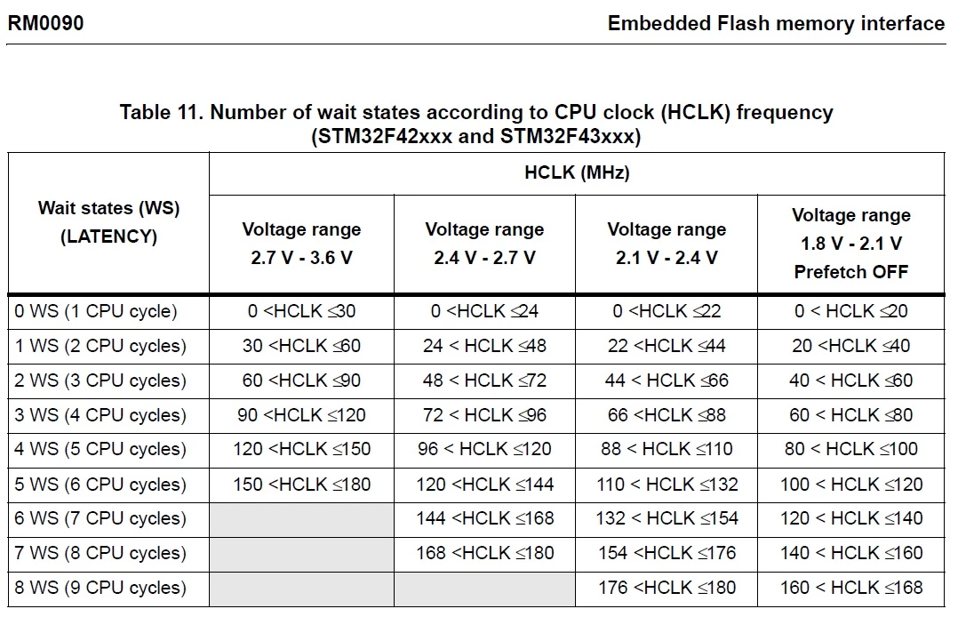

Looks like you should be at 2 wait states. Per the reference manual:
8 replies

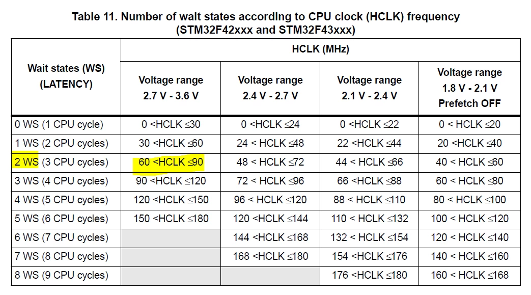

TDKBest answer
Jul 27, 2020 10:13 PM UTC

>>(HAL_RCC_ClockConfig(&RCC_ClkInitStruct, FLASH_LATENCY_1)
That's definitely not sufficient for 80 MHz

I'd be at 2 or 3, the ART can hide most of this, so I wouldn't try to catch the critical path

Exactly, I was also looking at the same table at the moment, with your suggestion. Thank you very much TDK!
I will try this and get back to here. For sure this one is a bug here.
