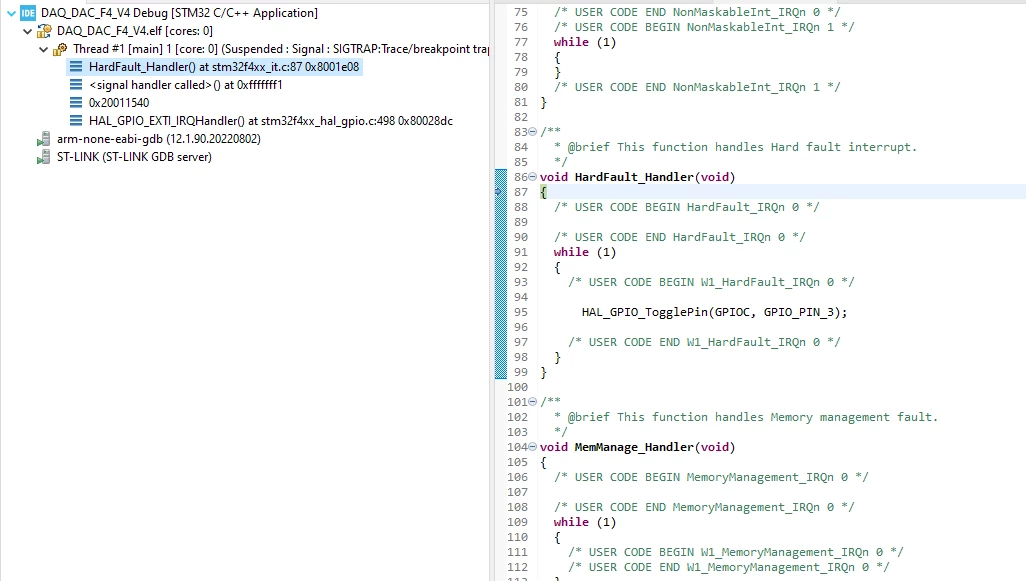

The sequence is step1: HAL_GPIO_EXTI_IRQHandler function is called and after that some issue happened and the hardfault handler is called. Can you show your code? In the interrupt handler can you toggle a port based on the external input signal, so both shall match for debugging purpose.

>>why?
These things don't need to be guessing games. Go identify what's actually faulting and work backward from there.
If you don't service interrupts in handlers, they'll keep entering.
Have a Hard Fault Handler that does something more useful that while(1), I've posted examples on multiple occasions on.

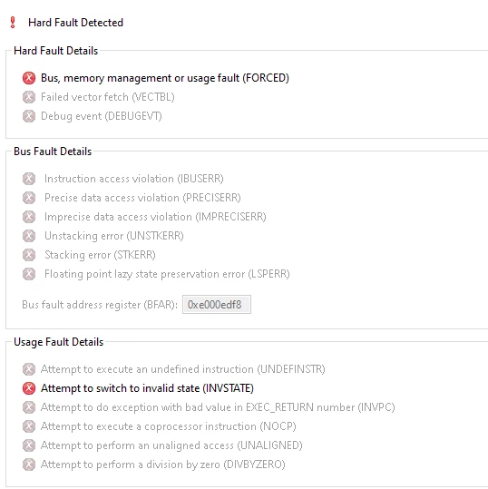

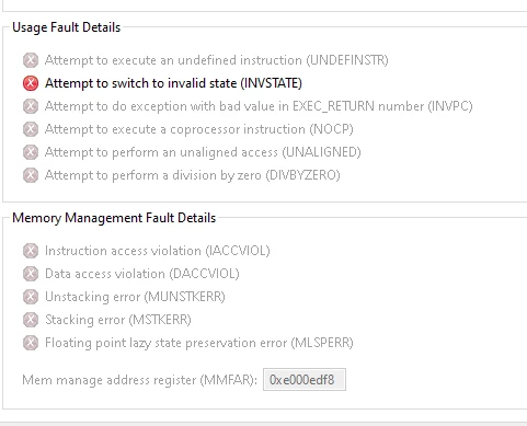

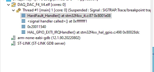

jhasa.2
jhasa.2Author
October 25, 2023
most of the time my code faults in EXT Interrupt
but i can not check which section trig this section.
this is the fault analyzer.

Pavel A.
October 25, 2023
In the stack trace 20011540 is a RAM address. How you've got there? This looks like stack corruption (overwrite).

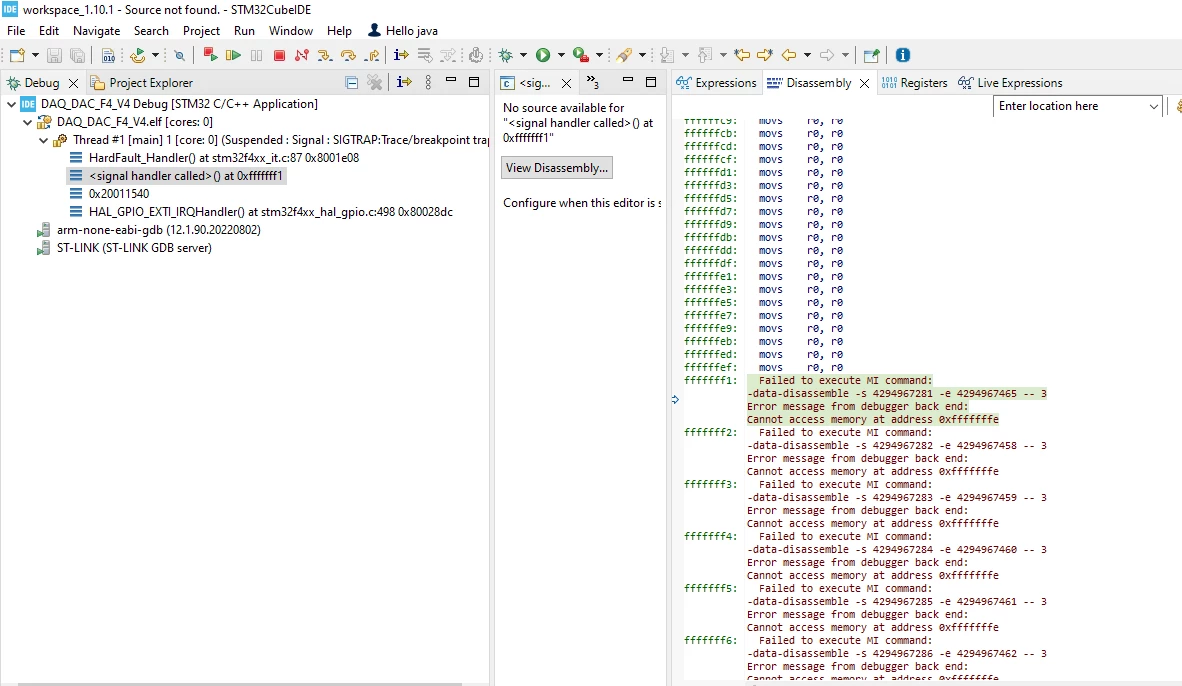

Shirley.Ye
October 27, 2023
you can check the disassembly file or use fromelf tool to analyze the stack data 0x20011540, what data is stored there?
