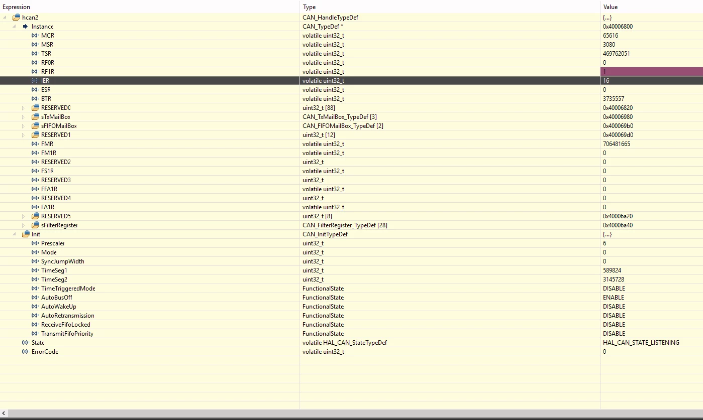

Hey Guys,
I have a problem using the CAN1 and CAN2 in dual use on the STM32F2427ZIT6 (custom board).
Hereby CAN1 is configured for FIFO0 Interrupt and,
CAN2 is configured for FIFO1 interrupt.
I managed to transmit and receive frames via CAN1. Also I manged to transmit frames with CAN2.
Furthermore if I send frames with the correct filter ID to CAN2 it does arrive in the FIFO1 memory.
(I can see it in the hcan2 handler instance with the RF1R bit switch to 1. Also I do see the frame data in the sFIFOMailbox[1] in the RDLR and RDHR fields.)
The problem is that the HAL_CAN_RxFifo1MsgPendingCallback is not called. Whereas when I use CAN1 the HAL_CAN_RxFifo0MsgPendingCallback works fine. So because I do receive the frame in the FIFO I think the filter settings are correct. Also the new firmware automatically is assigning the CAN1 handler for the filter settings in the ConfigFilter function.
Firmware version 1.21. is used.

In the image you can see the CAN2 Bits after receiving the frame. The callback function was not invoked.0690X0000060LQWQA2.png

    In order to have the HAL callbacks operate, you have to make sure that
    1. the related interrupt vector is enabled
    NVIC_EnableIRQ(CAN2_RX1_IRQn);
    2. the interrupt handler is implemented and contains the HAL handler redirection
    void CAN2_RX1_IRQHandler(void) { HAL_CAN_IRQHandler(&hcan2); }

    Rudolph Berger
    Jun 24, 2018 3:46 PM UTC
    Posted on June 24, 2018 at 15:46
    Thank you Ben, by default in CubeMX the interrupts on CAN are only enabled for RX0 so just be invoking HAL_CAN_ActivateNotification(hcan2, CAN_IT_RX_FIFO_MSG_PENDING) the NVIC_EnableIRQ(CAN2_RX1_IRQn) function is not invoked. This should maybe get changed in the next firmware update. Anyway thanks for your input.
