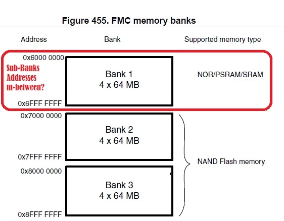

Well, as I'm starting to utilize the FMC/FSMC peripheral in one of my projects (interfacing a legacy chip), I have got some questions and would appreciate your help answering them.
According to the datasheet (memory mapping), each bank is divided into 4-sub banks, 64 MBytes each.
Aside from the fact that each bank assigns a unique Chip Select signal (CS), I couldn't find any reference to how one could calculate the offsets of these banks?
For example,
0x6400 0000 is the base address for the second bank (NE2), but how was that obtained? I mean, adding 64MB to the base address of 0x60000000 has resulted to something around 67MB.

    1MB=0x10'0000
    64MB=0x400'0000
    Thus, 0x6000'0000+0x400'0000=0x6400'0000 for NE2-controlled bank.
    0x6000'0000=1536MB=1.5GB

    Yep, that was correct, and I got it now! I wasn't multiplying by 1048576 (1MB), therefore I got a wrong value. Now, 1024*1024 =
    1048576 = 2^20.
    1048576 * 64  = 67108864 = 0x4000000. When added to the base address, we get
    0x64000000 for NE2.
