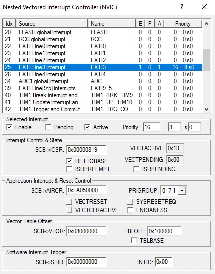

I'm using an stm32f411ce with an lsm6ds3 IMU and I want to trigger a read from the IMU with an EXTI. I've set it all in the code below and activated the interrupt on the IMU. the interrupt is set in PR register but handler is never called.

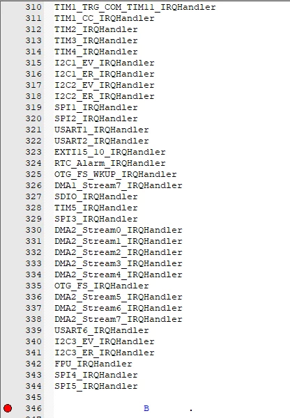

In the int handler I have added an LED toggle and turned off the bit 3 in the PR register by writing 1 to it. this never happens and the bit 3 is active on.
the vector table is as default.
This is what I see in the NVIC window 0693W00000FChWOQA1.pngand also in the code I just have a while loop after the EXTI and IMU initialization and whenever I stop the code with the debugger it goes to the brakepointed line0693W00000FChWdQAL.png
October 15, 2021
VECTACTIVE = 0x19, which means the processor is currently within the EXTI3_IRQ interrupt. So the interrupt is firing just fine.
Likely you just don't have the function implemented in your program anywhere so it defaults to the default handler. Check that the function you want it to call matches exactly with the name in the vector table (EXTI3_IRQHandler) and that it has C linkage. The output from the linker should tell you where EXTI3_IRQHandler is pointing.

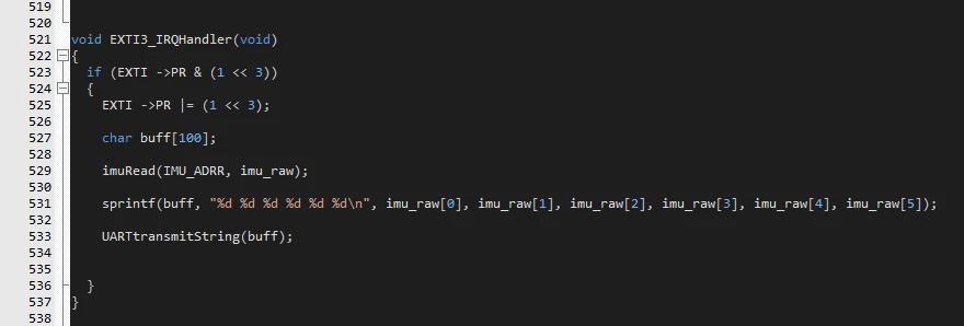

that is the handler implementation.
0693W00000FChi0QAD.pngdoes it seem fine?
waclawek.jan
October 15, 2021
C++?

not sure what you mean but I am using C++
TDKBest answer
October 15, 2021
So it has C++ linkage, not C linkage, which means the linker doesn't see it as EXTI3_IRQHandler.
To fix, surround it in extern "C" braces.
extern "C" {
void EXTI3_IRQHandler() {
