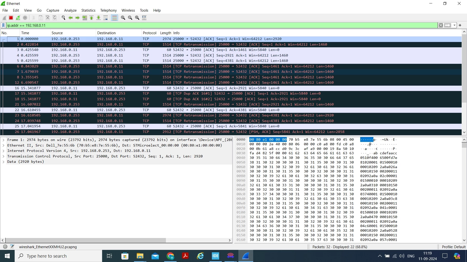

sometimes i am able to receive full packet of 14000 bytes sometimes it breaks in between.like after 7000 bytes (tcp raw lwip ,stm32f429vet6)or more it will stop receiving but stm32 pings and udp is also working at that time
But whenever i am using hercules to send 1024(last limit to send) bytes packet then i am able to send every time
I have checked in wireshark as the packet size increases ,retransmit of packet starts and then the problem arises

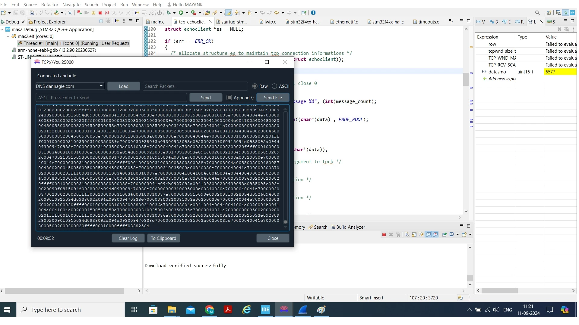

please find screen shot of packets being send as atatchemnt initially it receives perfectly some packet after that retransmission occurs as seen from wireshark screenshot now i hv used packetsender standard tool to send packets in order to explain my issue properly packets are received but very late in case packet is large microcontroller is never hanged i am sending some bytes through pachetsender so that are received as i hv made one u16 variable datasrno to count the no. of bytes received

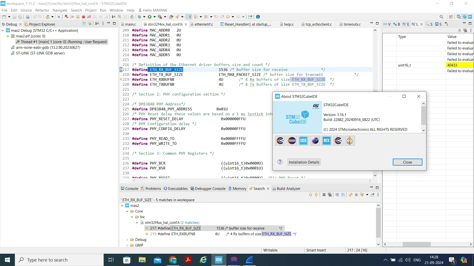

make sure you are using the lated version of cube Firmware as there was a bug reported related to V1.27
[ETH] fix constant receive buffer size by DedkovArtem · Pull Request #119 · STMicroelectronics/STM32CubeF4 (github.com)

I have checked version it is updated and #define ETH_RX_BUF_SIZE 1536 seems ok
Issue still remains unsolved still i am finding solution

Do you understand that TCP packet this big will be fragmented by the LwIP library to fragments that fit into the MTU size, which in turn is limited by L2 (ethernet) packet size?  If such packets do not work, look at the fragmentation/reassembly issues. Or - simpler - as TCP is a stream protocol, just send the large content in smaller TCP packets that do not need fragmentation. Break the large data in your application. Be happy.
