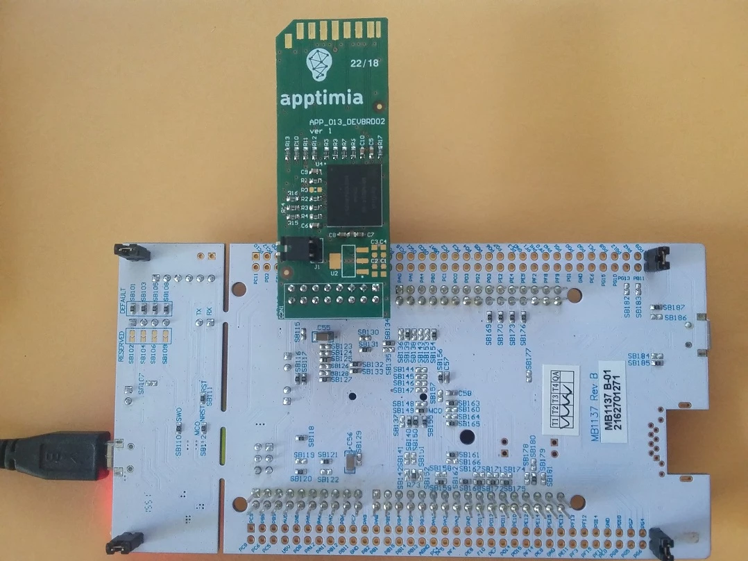

    I wouldn't expect pull-up resistors to have a great deal of impact against a push-pull driver running at a lower voltage. I'd think 2.6V would be clearly in the VIH range. Most of my systems run in the 2.85 to 3V ranges, but I've not reviewed the eMMC bus in that regard. You should perhaps look at the IO voltage applied/selection within the eMMC is calling for.
    Had a reasonable about of success with SanDisk/WDC and Samsung eMMC from 4GB to 128GB, on boards including the STM32F412-DISCO and NUCLEO-F412ZG
    I'll port a demo/integrity app to a specific platform, I'd need to know HSE clock source type/speed, USART and pins for debug/diagnostic output, and SDIO pins if beyond the stock PC[8..12] and PD2 configuration.
