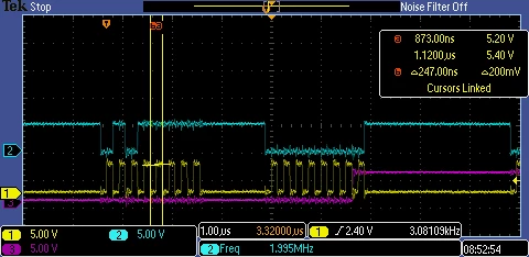

I'm trying to communicate between the
http://www.ti.com/product/ADS7870
and the ST microcontroller STM32F4 Discovery evaluation board. I'm using IAR and at the moment I'm just trying to read register 31 from the ADC (which should return a 1) but with no luck.
I'm setting the SPI on the microcontrontroller as follows: data transmitted as MSB first, clock low in idle state, data is captured on rising edge, data size is 8 bits, and full duplex transmission.

I'm attaching a screenshot of what I see on the scope. (yellow: sclk, blue: read command register 31, purple: output from ADC).
http://e2e.ti.com/cfs-file.ashx/__key/communityserver-discussions-components-files/73/67stm32f4_5F00_response_5F00_scope.PNG
MOSI transmits properly to the
(the din pin receives read command), but there is no response coming from the ADC dout pin.

    Jan 15, 2014 9:52 AM UTC
    Posted on January 15, 2014 at 10:52
    Don't you find disturbing that your waveform doesn't match the read waveform in the ADS7870 datasheet (Fig.18)?

    camila
    camilaAuthor
    Jan 16, 2014 12:10 PM UTC
    Posted on January 16, 2014 at 13:10
    I'm using an evaluation board, so there's no reset circuitry. I'm powering the ADC from VDD on the STM32 discovery, so the power is the same for both. I'm also placing a breakpoint before the initialization of the ADS7870, so there should be enough time for this to boot.
    camila
    camilaAuthor
    Jan 16, 2014 12:13 PM UTC
    Posted on January 16, 2014 at 13:13
    It is the same waveform. Data is latched in the rising edge as in the datasheet.

    waclawek.jan
    Jan 16, 2014 12:58 PM UTC
    Posted on January 16, 2014 at 13:58
    No, it is not. The datasheet figure shows the command LSB first, yours is MSB first.
    Meantime, reading the datasheet revealed, that it features both, and MSB first is the default. A cunning way to mislead the casual reader...
    Also, you don't show the /CS signal. The description in the datasheet indicates, that it's important to have a low-going transition on /CS before start of communication. There is an alternative procedure described on the bottom of page 17.
    But that's only if the RISE/FALL pin is tied to 1. How is it in your circuit?
    > Here is the waveform I obtain when using the ADS7870 with ATMEGA8 (where everything works properly).
    Then what are the differences between these two cases?
    waclawek.jan
    Jan 16, 2014 1:03 PM UTC
    Posted on January 16, 2014 at 14:03
    One more thing - the waveform you presented above exhibits significant ringing on the edges. If these are real and not only artifacts of improper measurement setup, they may be seen by the SPI receiver in the ADC as false clocks and throw the receiver out of sync.
