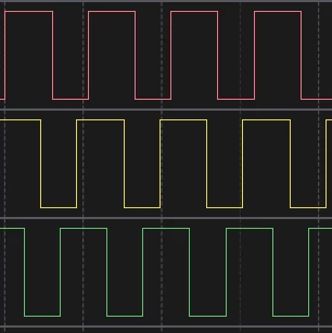

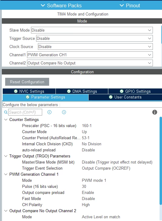

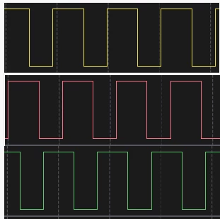

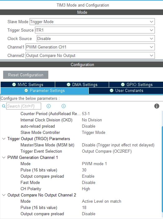

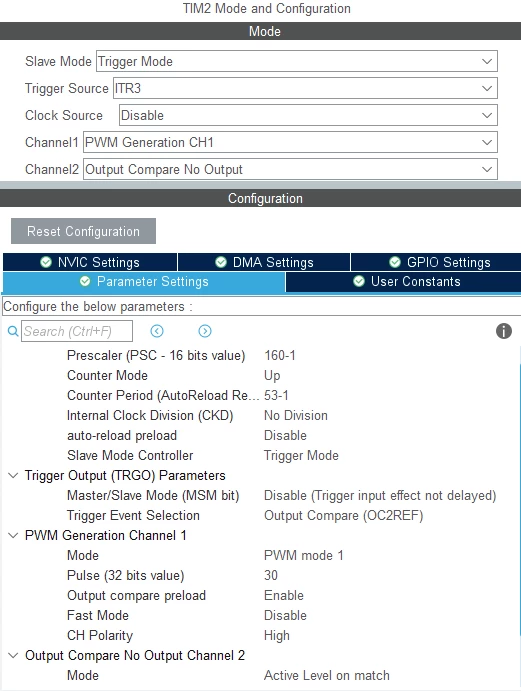

Stm32f4 DISCOVERY/ Trying to change slave mode and trigger source with REGISTERS for 3 phase shifted PWM.
I read datasheet stm32f407vgt6 datasheet TIMx slave mode control register (TIMx_SMCR) configured as datasheet said but doesnt works. I shared my mainC I am beginner in embedded software and register programming. also ı Shared my timer configs cubeIDE0693W00000Y6t2yQAB.pngthis is I genereted with cubeIDE settings 0693W00000Y6t3DQAR.pngthis is one of the configurations i want to change with slave mode and trigger source regsiters.
these are the my cube IDE settings
