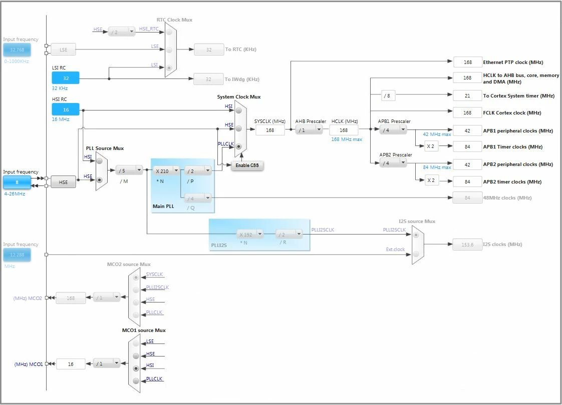

I am trying to toggle an I/O line to measure timing for benchmarking dsp algorithms on an STM32F407VGT. I generated the HAL using STM32CubeMX and set PD12 and PC8 to outputs and configured them as output push-pull with no pull-up. The generated code includes the following which is called prior to entering the infinite while in main().
  /*Configure GPIO pin : PD12 */
  GPIO_InitStruct.Pin = GPIO_PIN_12;
  GPIO_InitStruct.Speed = GPIO_SPEED_MEDIUM;
  HAL_GPIO_Init(GPIOD, &GPIO_InitStruct);
Later I use the following to set and reset the I/O pin:
        // Set PD12 at the beginning of the calculation
        HAL_GPIO_WritePin(GPIOD, 12, GPIO_PIN_SET);
        // Clear PD12 at the end of the calculation
        HAL_GPIO_WritePin(GPIOD, 12, GPIO_PIN_RESET);
Yet, the I/O pin is not toggling. I believe I configured the clock tree correctly and I'll include a screen grab from STM32CubeMX. Am I missing anything obvious? Thanks!
