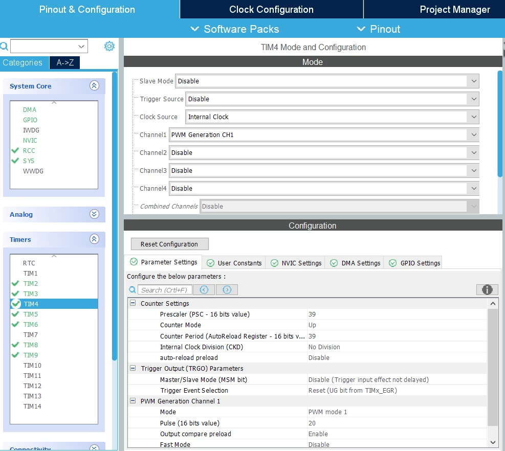

Stm32F4 Discovery Generate Pwm signals have different frequencies and Dac Signal with DMA
  • August 13, 2022
  • 0 replies
  • 950 views

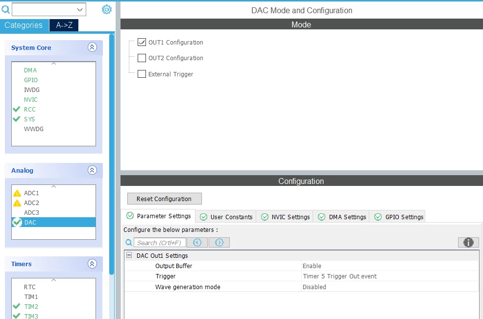

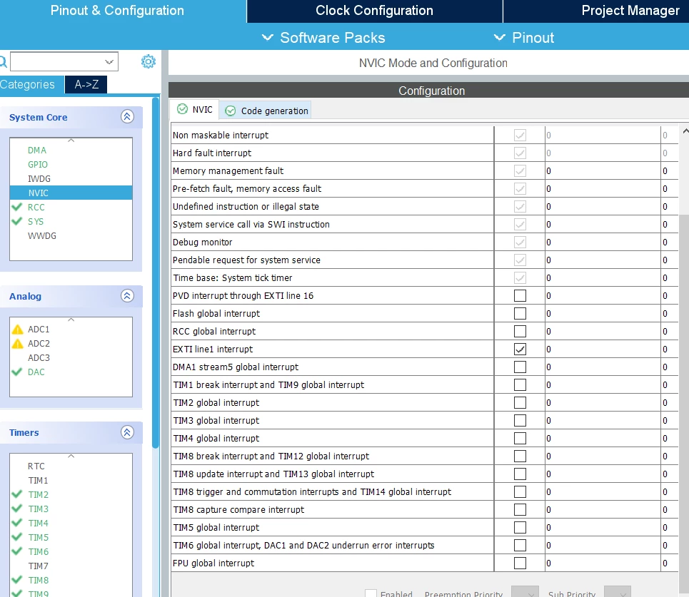

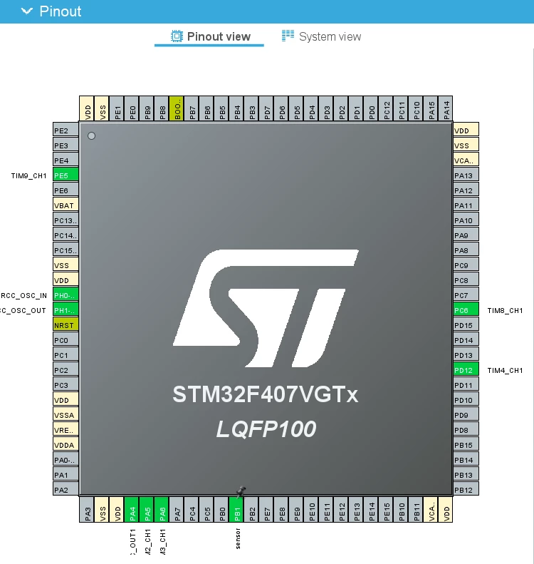

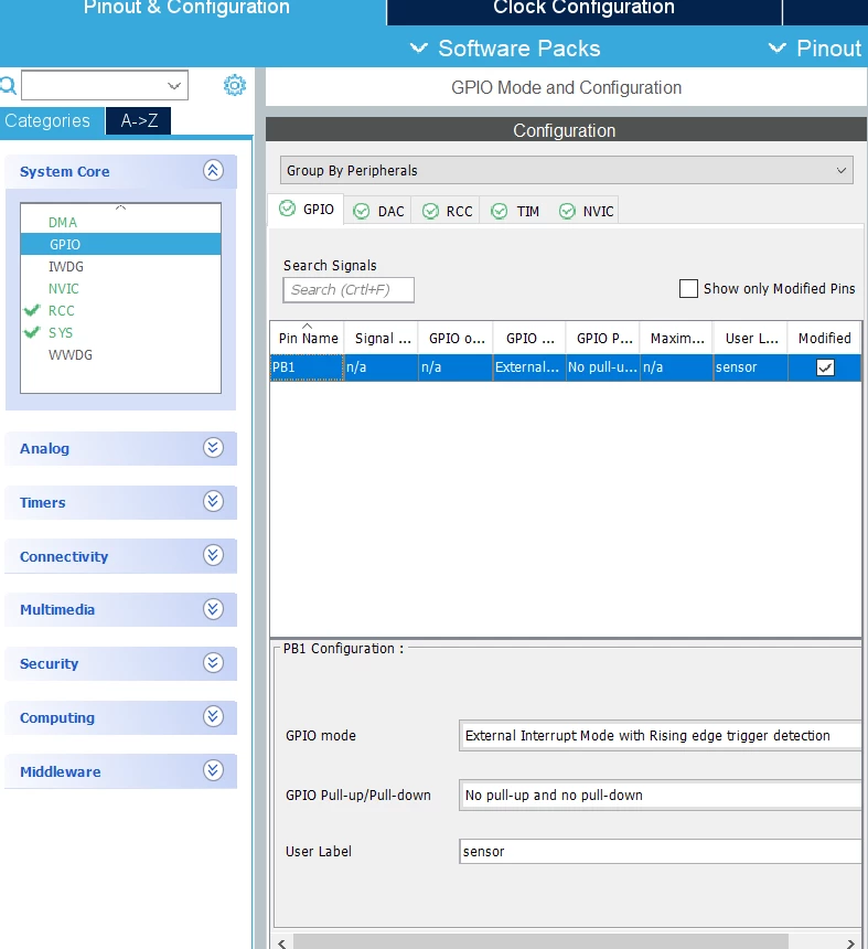

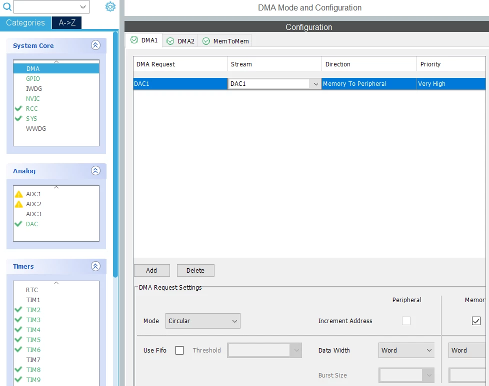

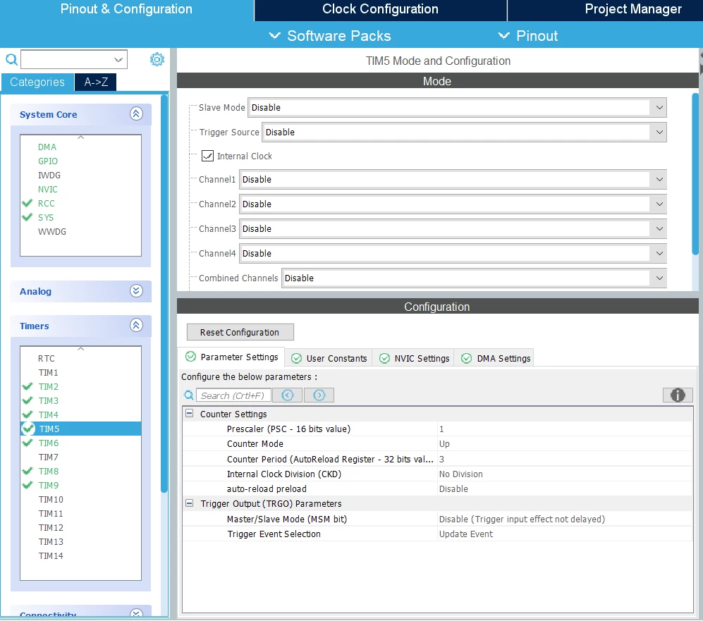

I have a sensor which generate an input signal. By using this signal rising edge , I want to generate some pwm signals and additional Dac signal from DMA which synchronize with input Signal. When I visualize signals on ossiloscope , I aware some slip between signals and it is not stable. if you have any suggest or method please help me.
I use GPIO EXT to capture input signal.
Tim5 to control Dac Sıgnal
Other Timers for Pwm Signal
My Code is below.
