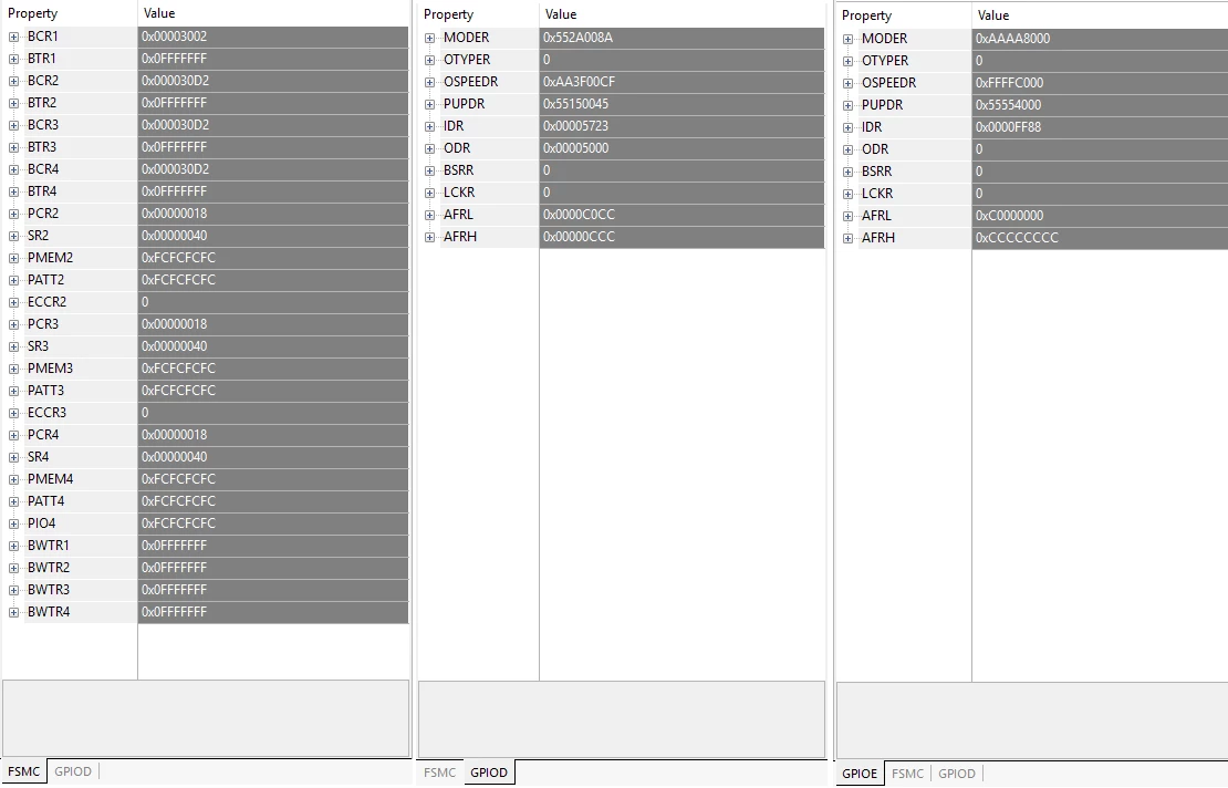

    Kasapoglu.Orkun
    Senior
    January 14, 2016
    Posted on January 14, 2016 at 15:00
    Here is the FSMC, GPIOD and GPIOE registers and their contents.
    waclawek.jan
    January 14, 2016
    Posted on January 14, 2016 at 16:40
    While I wrote ''post register content'', I meant ''look at the registers content and think yourself'' :)
    FSMC_BTR1 is uninitialized.
    I don't ''speak'' SPL nor Cube, but I suspect what you did is not the proper way how the FSMC should be initialized.
