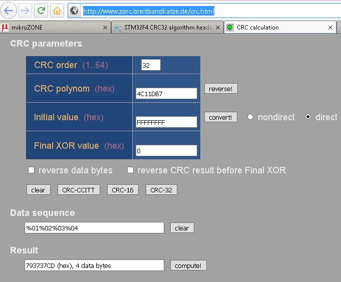

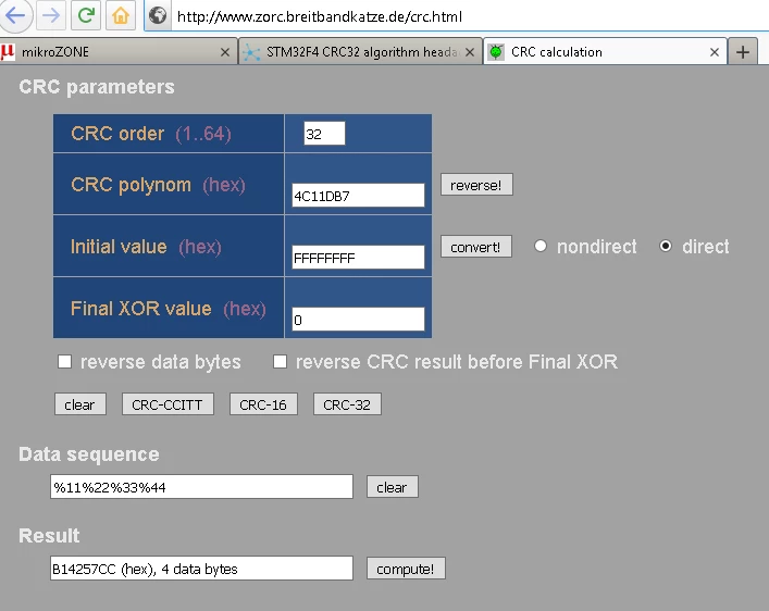

Besides Clive's program, the srecord package embeds also a STM32 CRC calculation (arguably it's not the easiest to use though). This is my favourite CRC online calculator http://www.zorc.breitbandkatze.de/crc.html with Clive's data (note the tickboxes' settings):
and your data:
One way how to check if your CRC calculation is not completely failed is to append the result to the checksummed data and perform the CRC again; the result should be 0 - this is what Clive did in hist last example.

"One way how to check if your CRC calculation is not completely failed is to append the result to the checksummed data and perform the CRC again; the result should be 0 - this is what Clive did in hist last example."
Thankyou, I'd completely forgotten about this!
I was able to prove my CRC function was in error, and then located the fault in fairly short order. (It was a daft typo mucking up the last word of the input data. Yesterday was a no brain day.)
