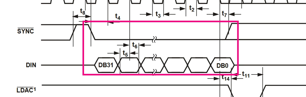

Ouch, I'm not even flipping CS (SYNC), just only once before the first message. My SPI transfers are 8-bit long and the whole message is 32-bit, so that part seems alright. I can find libraries for that chip and they do in fact set CS HIGH after the 4 x 8-bit SPI transfers.
As per datasheet:5668-sync.png
So now I must find a way to control CS based on DMA transfer count with handlers and move everything to a 48 kHz timer to send one command per tick.
Edit: And also reduce the buffer size to the message size (32 bits) and on each TC interrupt set CS high and set the next consecutive M0AR address?
July 5, 2025
Yep, you understand what needs to happen.
Set CS high when the SPI is done, not when TC is raised. TC only indicates the DMA has transferred all data. You can take a look at HAL_SPI_TransmitReceive_DMA fow how this is done correctly.
Newer chip families handle this better. On F4, options are fewer. Synchronizing a PWM signal to act as CS can work if done correctly.
