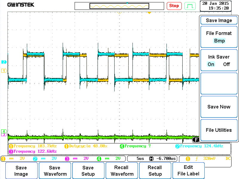

    Posted on January 20, 2015 at 02:02

    Posted on January 20, 2015 at 02:30
    Can anyone help me, please?!
    Not really, not my thing at all...
              TIM_OCInitStructure.TIM_OCIdleState        = TIM_OCIdleState_Reset; // Sure this isn't Set ?
              TIM_OCInitStructure.TIM_OCNIdleState = TIM_OCNIdleState_Reset;

    Posted on January 20, 2015 at 13:51
    Thank you for your response.
    I have tried disabling the PWM channel 3, 3N to test the other two only (PWM channel 1,1N ~ PA8, PB13), but the problem has still remained. The complementary feature doesn't work (the following picture). So complicated!!
    Although dont think the idle feature isn't neccessary in this case, I have tried to SET it as you said, and the result is not better.
    I use 50kHz TIM2 Interrupt for Calculation (ADC, Controller, update,...), and TIM1 for PWM (frequency and dutycycle vary; deadtime constant)

    Posted on January 20, 2015 at 14:15
    The scope traces look very odd, do the complementary outputs look right if the deadtime stuff is removed?

    Posted on January 20, 2015 at 14:51
    It is not better, Clive1.
    The overlap happens randomly when I run/stop my Oscilloscope.
    I have no idea to do next. Haizz!!
    I can send to you all my project. Can you help me find out the problem?
