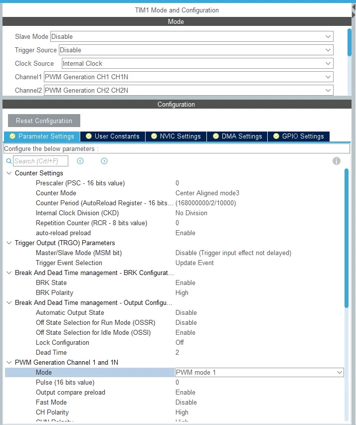

I configured timer1 for pwm generation center aligned like below in cube ide.
I update duty cycle writing directly CCRx register asyncronously in the code.

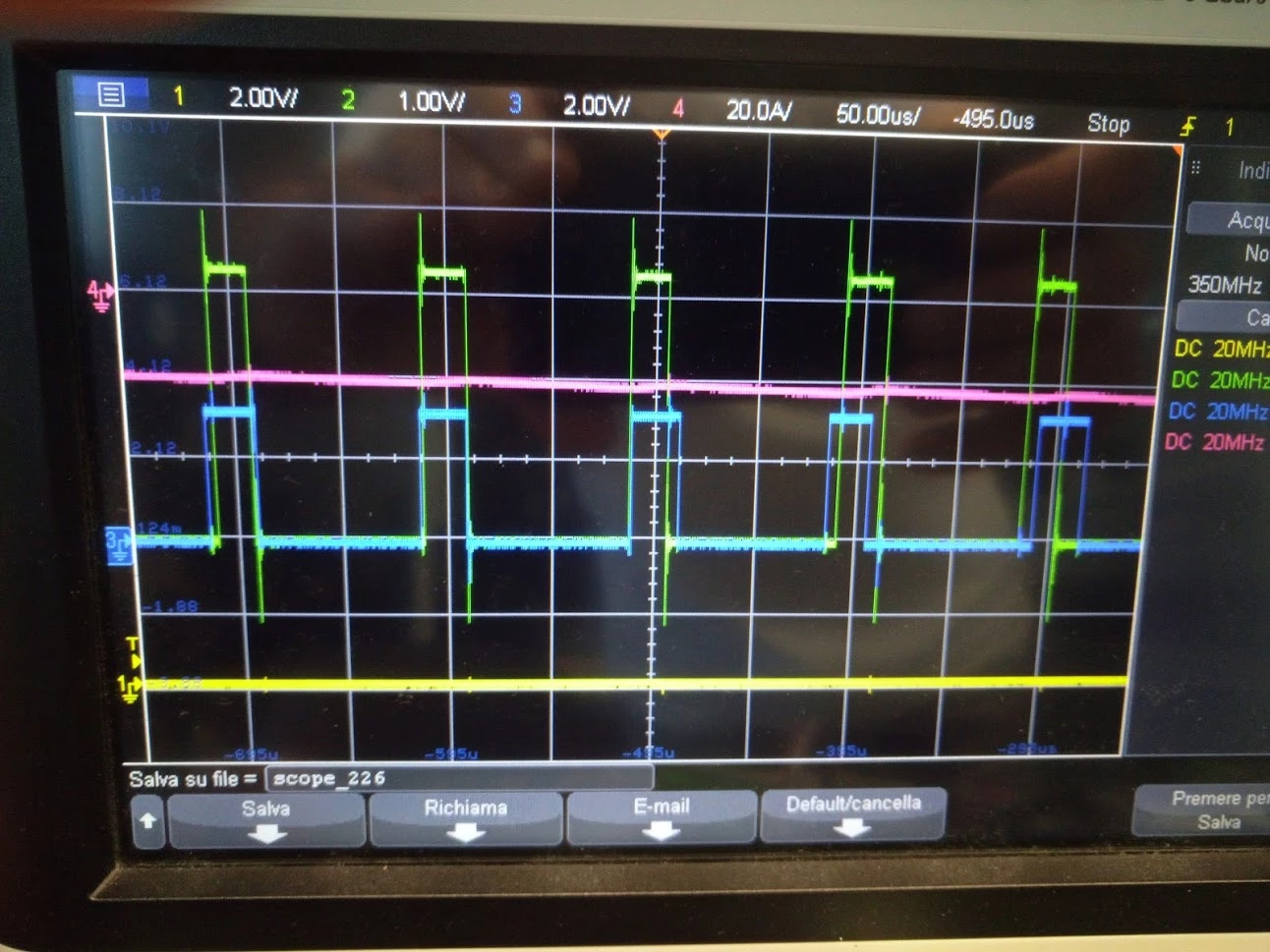

Most of the time pulses are effectively center aligned but sometimes not (nor left or right aligned). Please, a suggestion.
