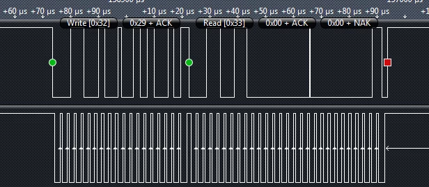

Hi all,
i recently started working on a orientation project using iNemo aplication, despite the dificulty of using pre build sensor libs, i said ''i`ll build my own''. Said and done, but when i try to read a single register there is 0x00 data on the buss The I2C works fine, except after sending the read comand ( 0x33) the data is 0x00 0x00 I tryied this reading only one axis, for example the X axis. Bellow is my init routine and the reading function

The read function
void LSM303_Read(uint16_t x_a){
//uint16_t x_a;
i2c_start_com();
i2c_wrAddr(awAddr); //0x32
i2c_Wrbyte(OUT_X_H_A); // 0x29 Select Acc Y register
i2c_start_com(); // restart signal
i2c_rdAddr(arAddr);//0x33
uint8_t x_h_a=i2c_rdAck();// get acc x MSB;
uint8_t x_l_a=i2c_rdNack(); // get acc x LSB;
x_a=(x_h_a<<
8
)+x_l_a;
I2Cx->CR1 |= I2C_CR1_STOP; /* Generate a STOP condition */
Bellow are some screent shots taken with logic analizer on the bus. I am missing something in the config registers? 0690X00000604trQAA.png

    Posted on August 11, 2014 at 07:06
    after spending some good hours trying to figure out whats wrong, i got to the conclusion that if i enable the accelerometer alone everything is fine, i get readings on all 3 axis, but if i enable the magnetometer then everything gets stuck.
    Anyone experienced this issue before?
