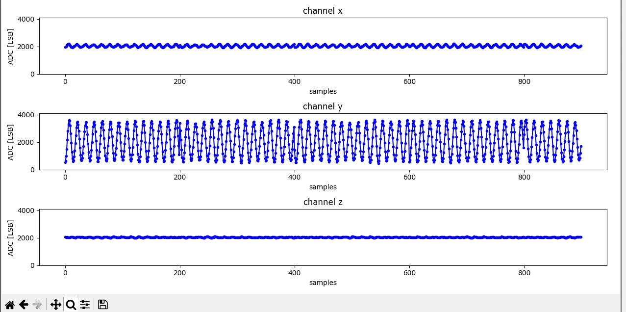

The faulty output with discontinuities each 100 samples:

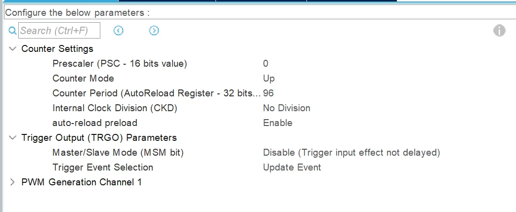

Timer configuration (96Mhz clock)

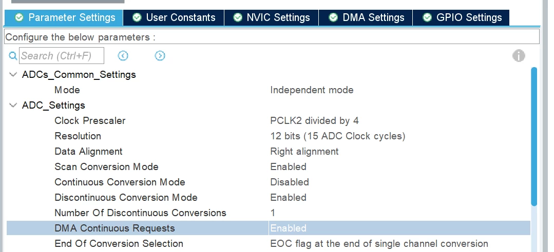

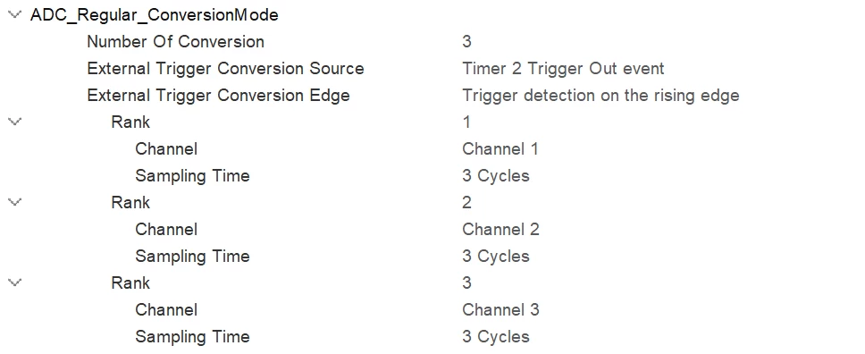

ADC configuration
