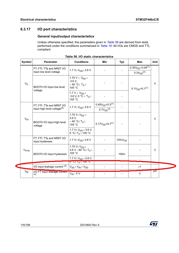

STM32F4 A/D Input Bias Current

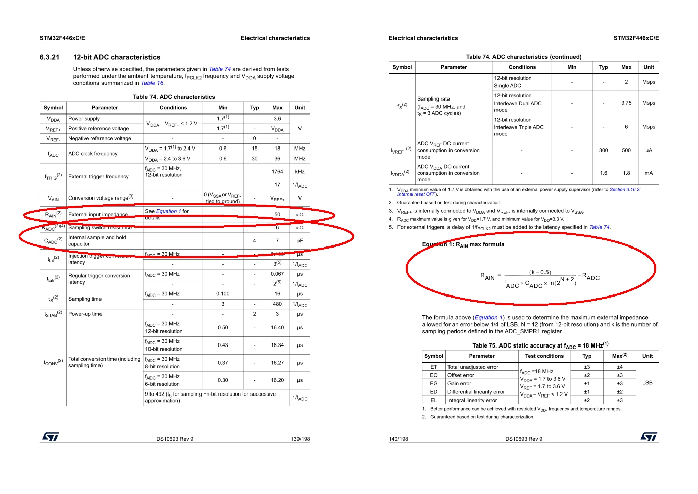

I'm not able to find a spec in the STM32F446 datasheet for minimum A/D input bias current. Does anyone know where I can find this info? I need to sample the voltage from a high resistance potentiometer and it would be handy to know if I need to buffer prior to connecting to A/D pin. Thanks!
waclawek.jan
waclawek.janBest answer
February 20, 2023
Static current is given by
But this is never the limiting factor.
This is:
0693W00000aHCopQAG.pngThe ADC input is a switched capacitor,, and you have to ensure it is fully charged to input signal's level during the sampling phase of conversion.
